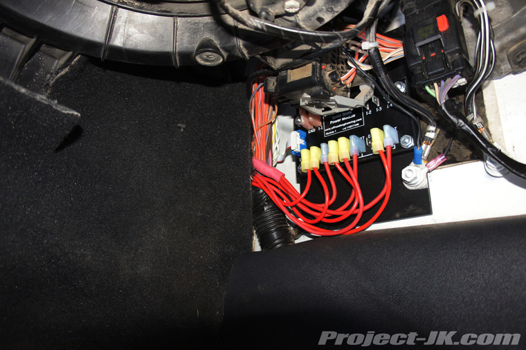

Here what the power module looks like installed and wired up...

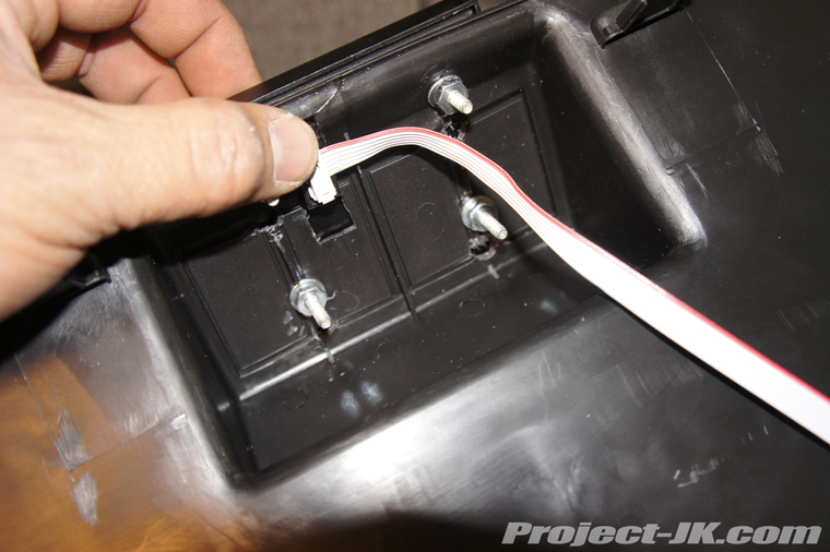

Here you can see just how thin and small the ribbon cable is that connects the power module to the actual switch panel. Had the Daystar panel not worked, I would have just installed this directly on the factory panel or along the center console under the hand brake...
Like I said, installation was a piece of cake and wiring was now easier to do than ever before. I think the hardest part of this install was cleaning up the mess I had under the hood first so that I could have a clean slate to work with. In retrospect, I might have gotten an 8 switch panel so that I could make 2 of the buttons operate my winch - IN for one button and OUT for the other. I will try to get a complete write-up done for this as soon as possible but, it'll most likely be after the holidays. :yup:
