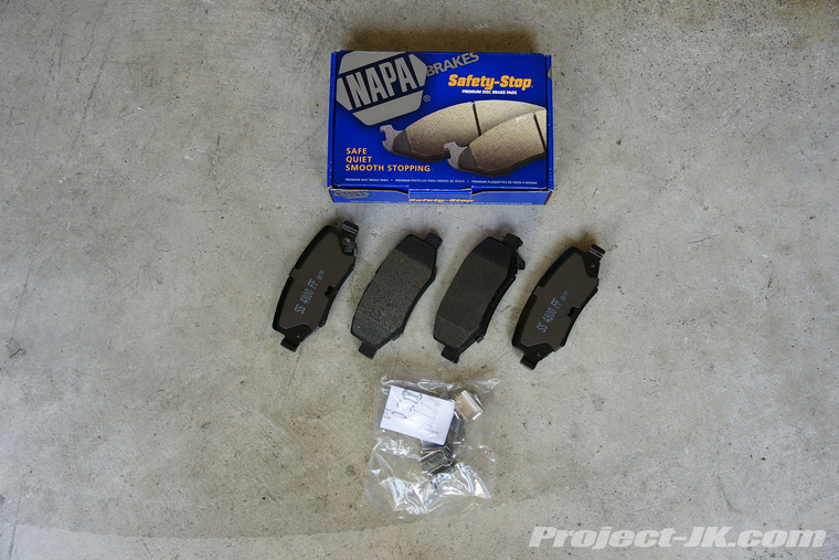

This is a pic of everything you will get with your new brake pads. Basically, a set of 4 new pads (2 of which should have new sounders) and a set of replacement retaining clips.

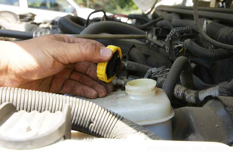

1. Open up your master cylinder and check the fluid level. If you had not been adding more fluid to it, you should see that it is low now. If you have been adding to it, you may find it necessary to bleed your rear brakes a bit before continuing. Failure to do so will result in the overflowing of your master cylinder once you install your new brake pads.

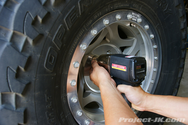

3. Using a 19mm socket or a tire iron, remove the lug nuts securing your rear wheels to your axles and set them aside.

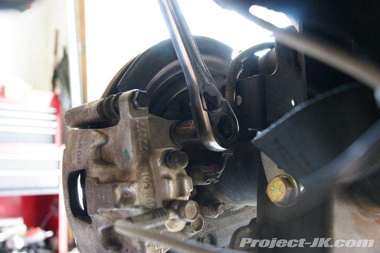

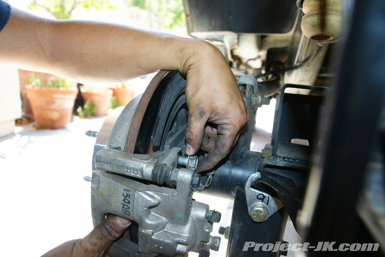

4. Using an 18mm wrench, remove the lower bolt securing the rear brake caliper to the axle as shown in this pic.
5. Again, using an 18mm wrench, remove the upper bolt securing the rear brake caliper to the axle as shown in this pic.

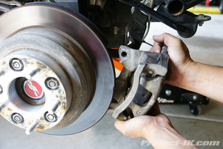

6. With the 2 bolts removed, you should be able to slide the brake calipers off the rear rotors with ease. Carefully inspect your rotors and if they appear to be heavily scored, take them in to your local auto parts store and have them turned or replaced as needed.

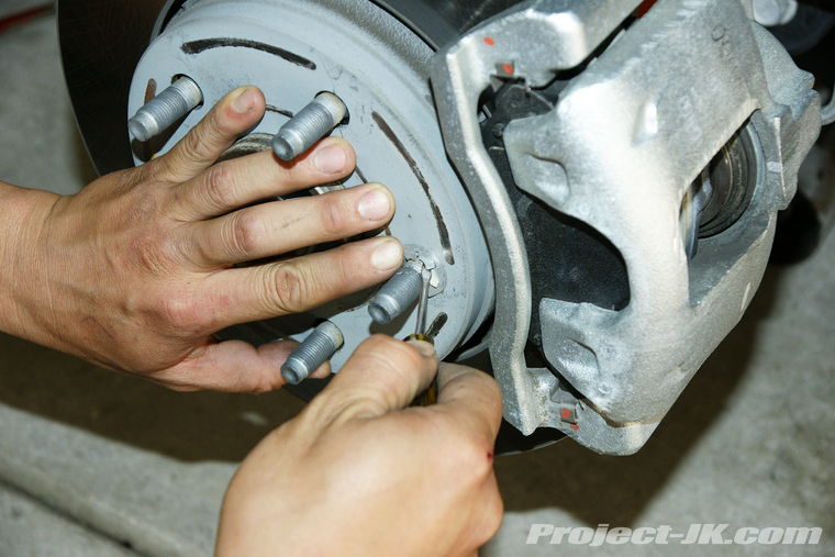

7. If this is the first time removing your rotors for service or replacement, you will need to first remove a couple of assembly washers securing it in place. These washers are attached to the wheel studs and will require a small flathead screwdriver and/or needle nose pliers to remove. Once off, you can throw them away as the will not be reused.

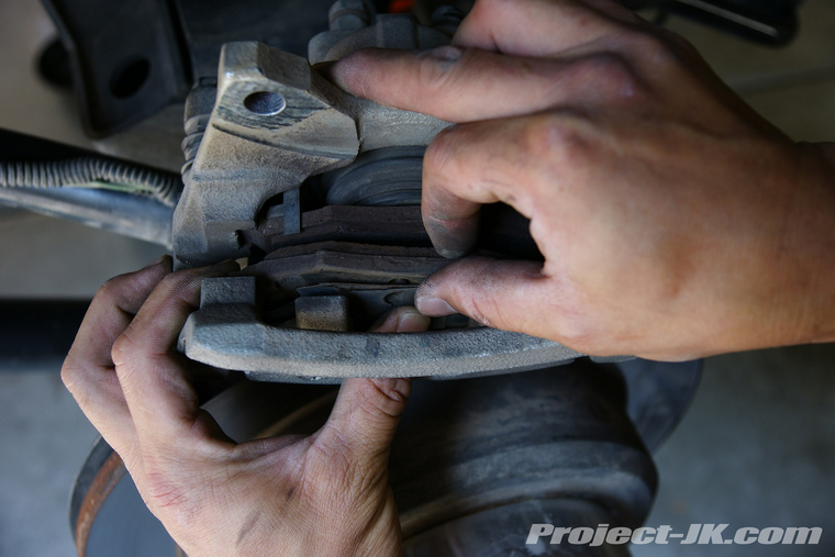

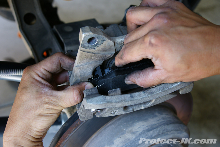

9. Remove the outer brake pad from the rear caliper by pushing it towards the opposite pad as shown in this pic.

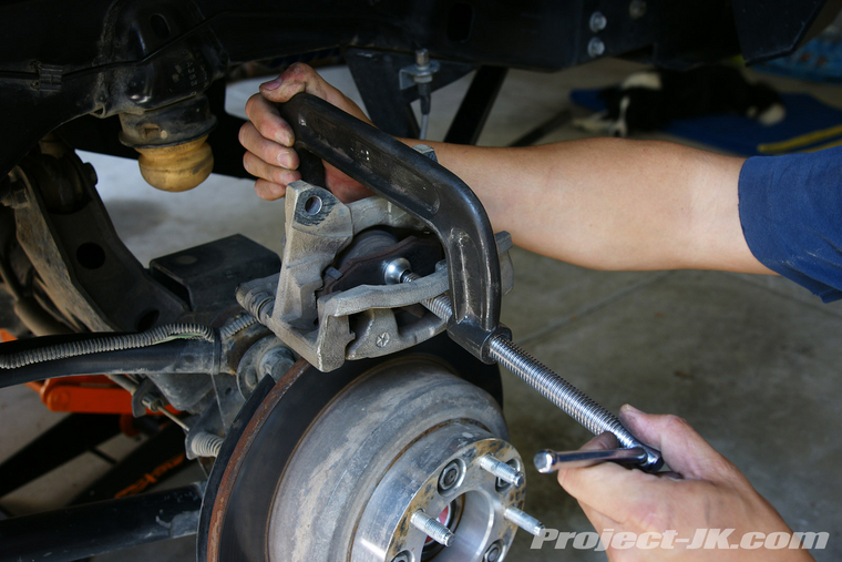

10. Place a large C-clamp over the remaining brake pad and the back of the caliper as shown above. Slowly compress the C-clamp so that the caliper piston is forced all the way back inside.

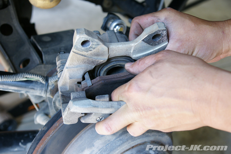

11. Remove the inner brake pad from the rear caliper by pushing it out as shown in this pic.

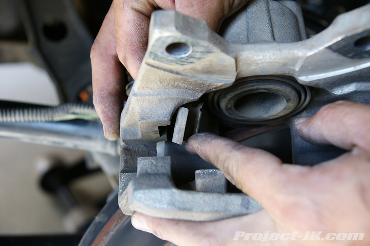

12. Make a note of how they are installed and then remove the 2 brake pad retaining clips on each side of the rear calipers as shown in this pic.

18. Check the level of your master cylinder and add more brake fluid if needed.
19. Reinstall your wheels, tighten the lug nuts to 95 ft. lbs. of torque and lower your Jeep back onto the ground. Your Jeep JK Wrangler’s rear breaks should be in good order once again.
