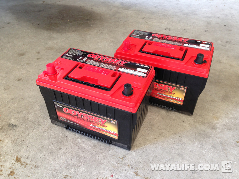

And, this is a shot of the two 34-PC1500T ODYSSEY Extreme Batteries we will be running.

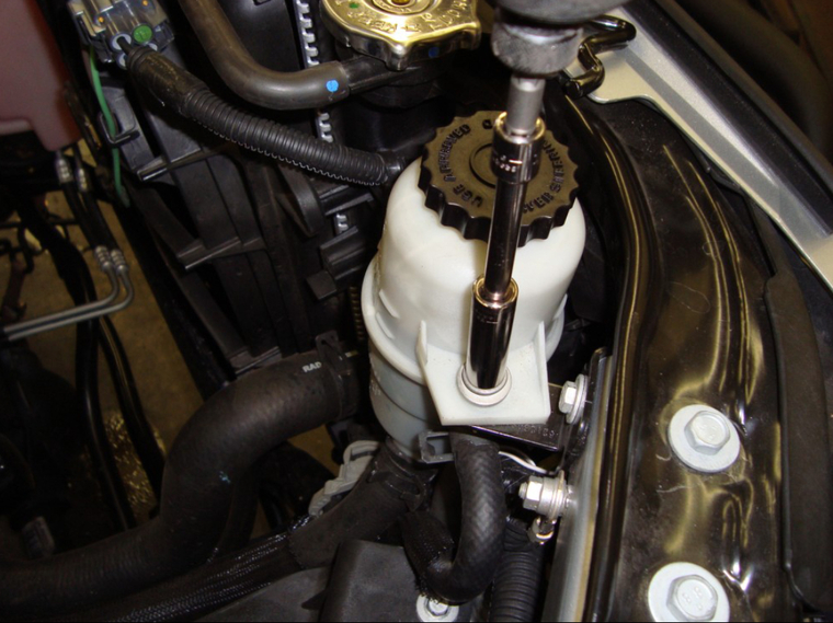

4. Use a 10mm socket to remove the bolt securing the power steering reservoir in place. Move reservoir out of the way.

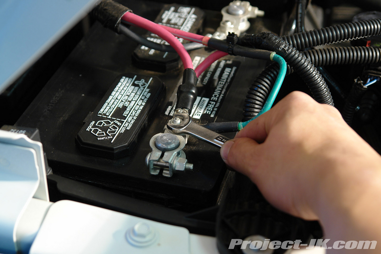

5. Use a 10mm wrench to disconnect the battery leads.
6. Use a 10mm wrench to disconnect the ground wire attached to the side of the body as shown.

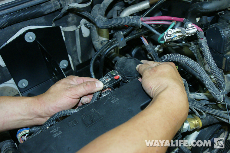

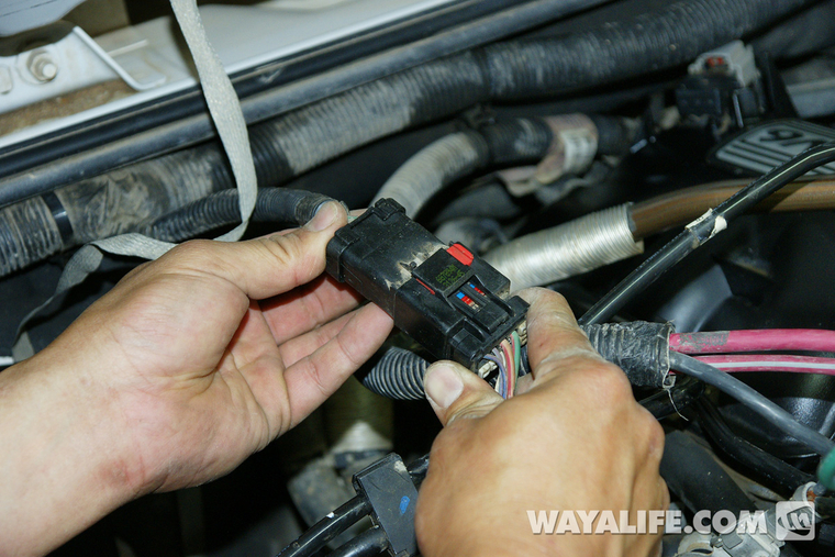

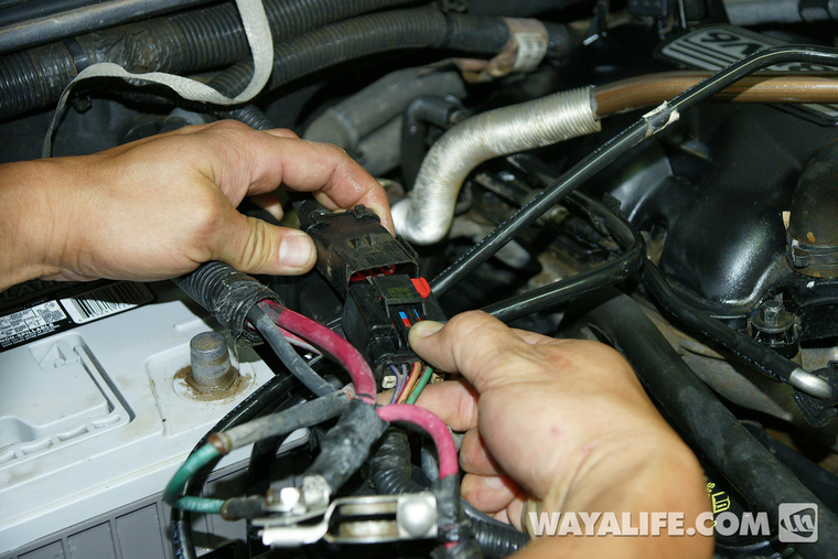

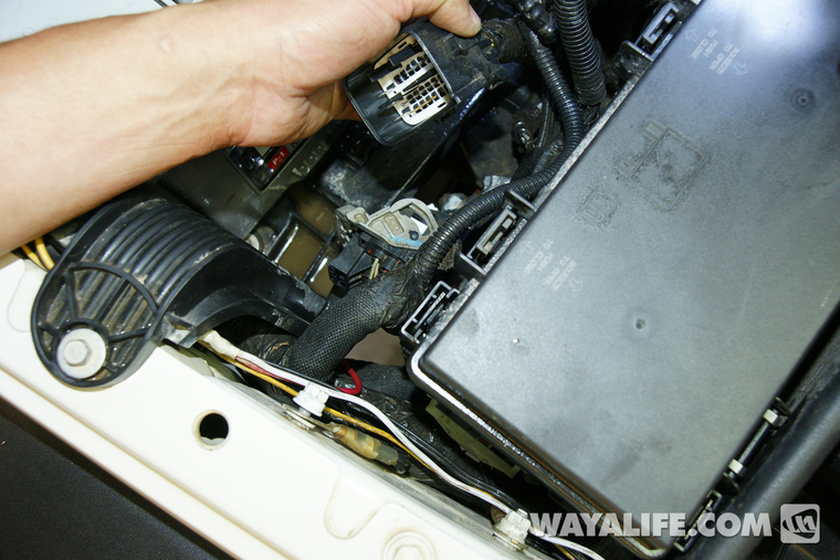

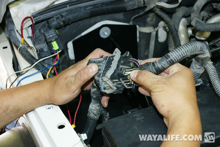

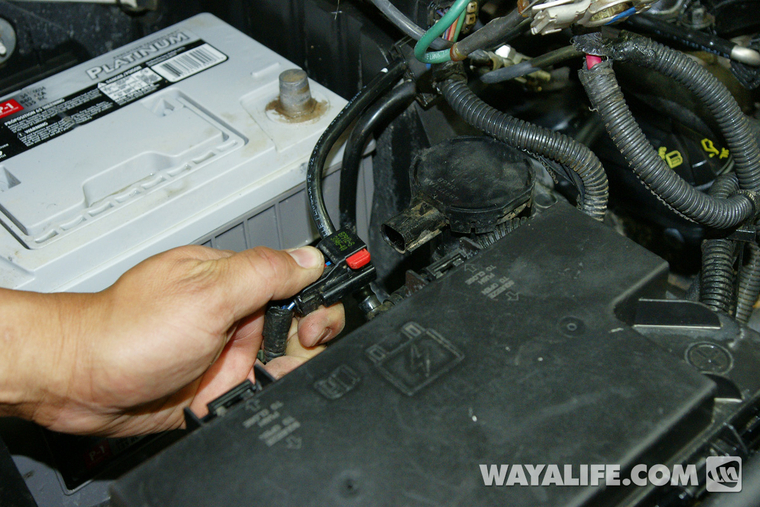

7. Unlock and unplug the wiring harness coupler next to the battery.

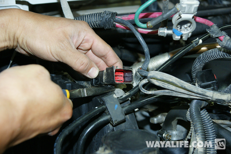

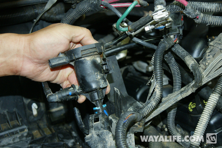

8. Unlock and unplug the wiring harness from the purge control valve.
9. Unlock and unplug the large wiring harness coupler sitting between the battery and TIPM.

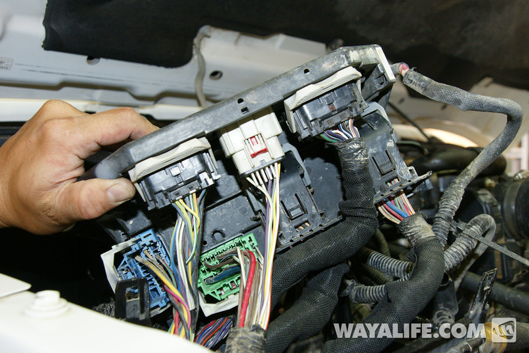

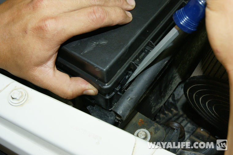

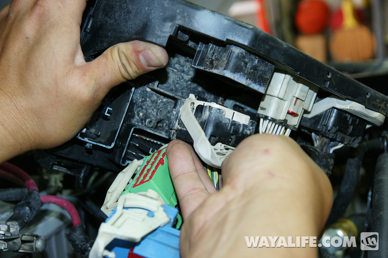

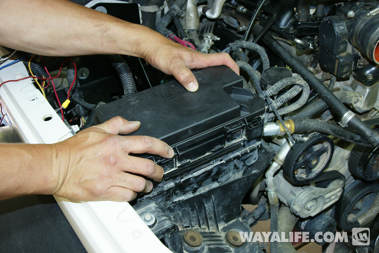

10. Use a flathead screwdriver to free the tabs securing the TIPM onto its mount as shown.
11. Carefully lift the TIPM up off its mount.

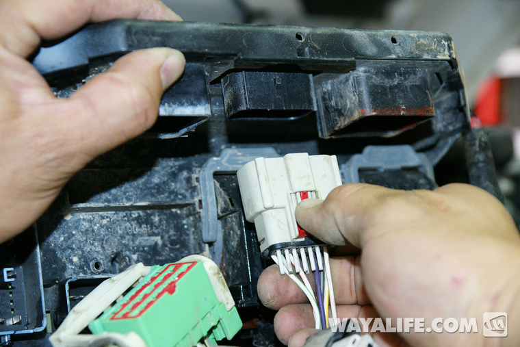

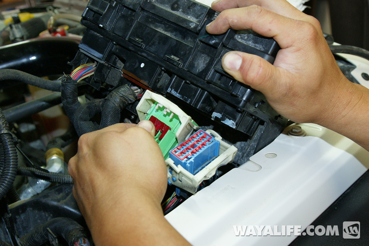

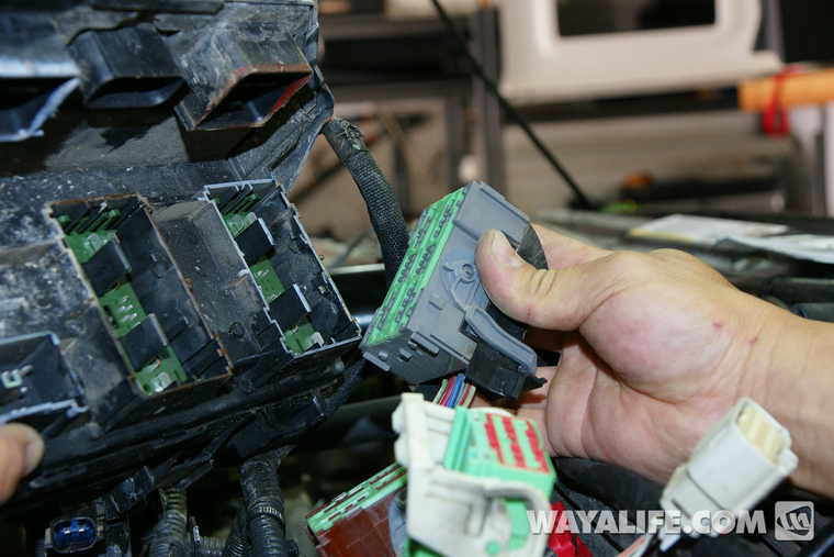

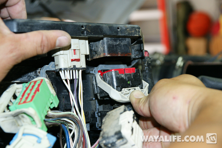

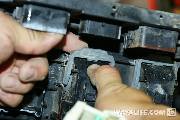

12. Unlock and unplug all the wiring harness connectors attached to the TIPM.

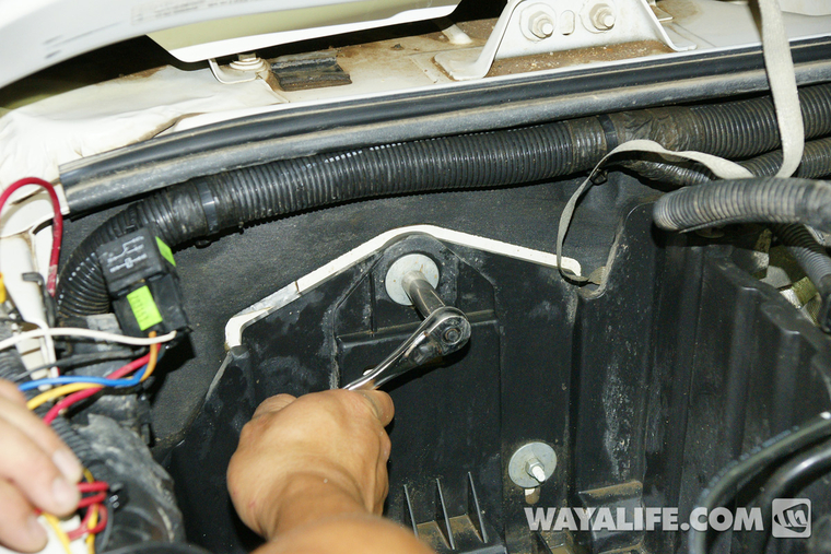

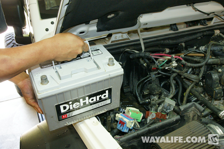

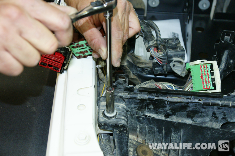

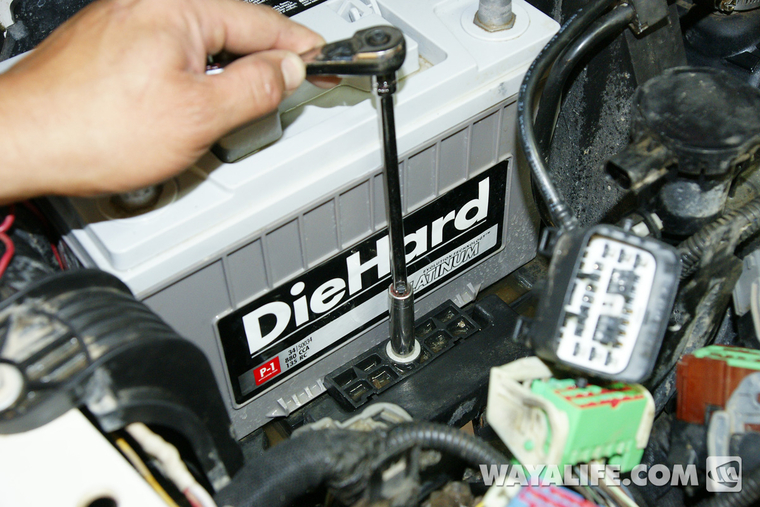

13. Set aside the TIPM and then, using a 10mm socket attached to a long ratchet extension, remove the clamp securing your battery in place.
14. Remove your battery.

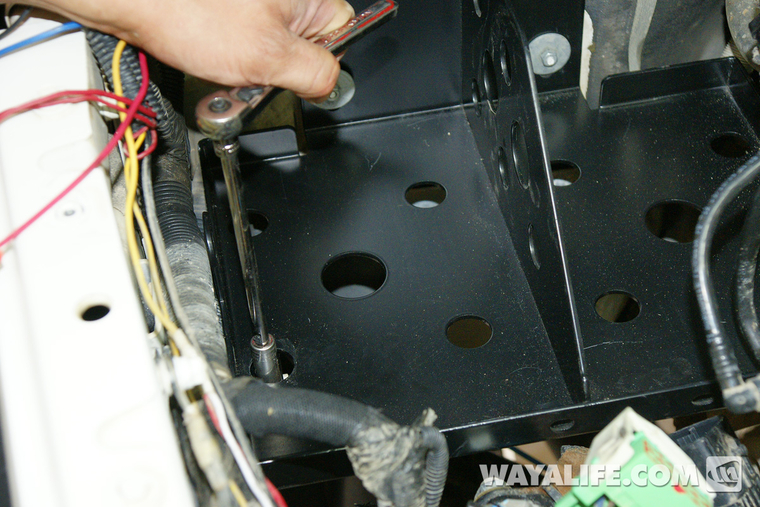

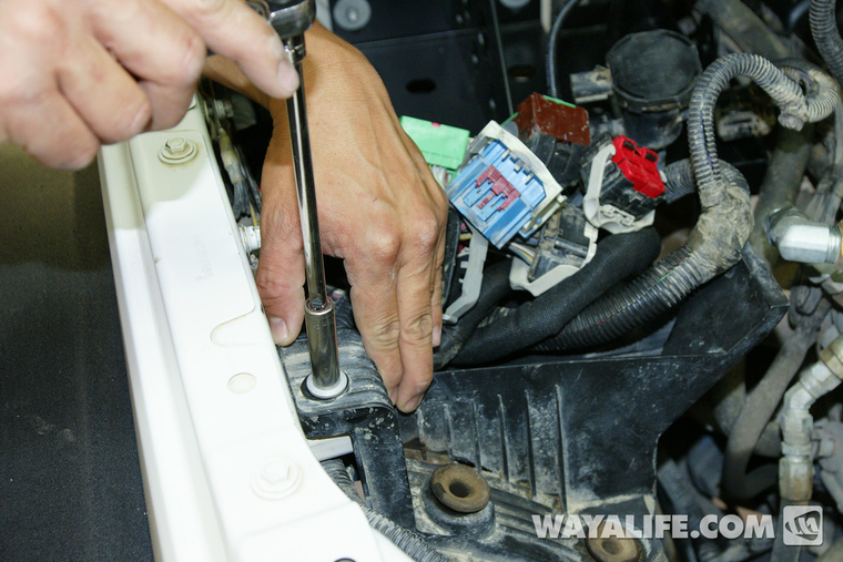

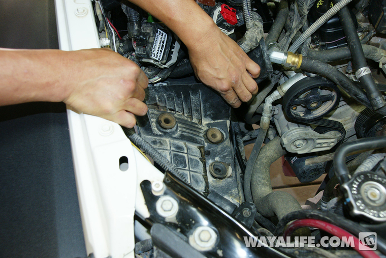

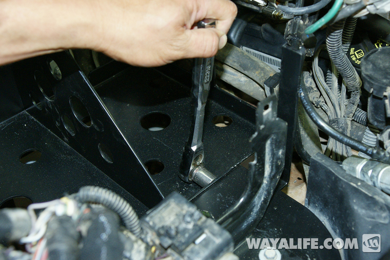

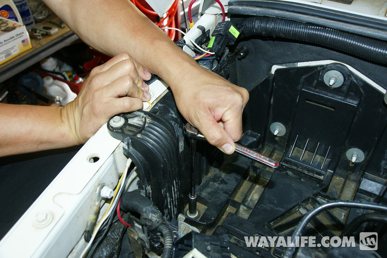

15. Use a 10mm socket to remove the 4 bolts securing the bottom of your battery tray in place.
16. Use a 10mm socket to remove the 3 nuts securing the battery tray to the firewall.

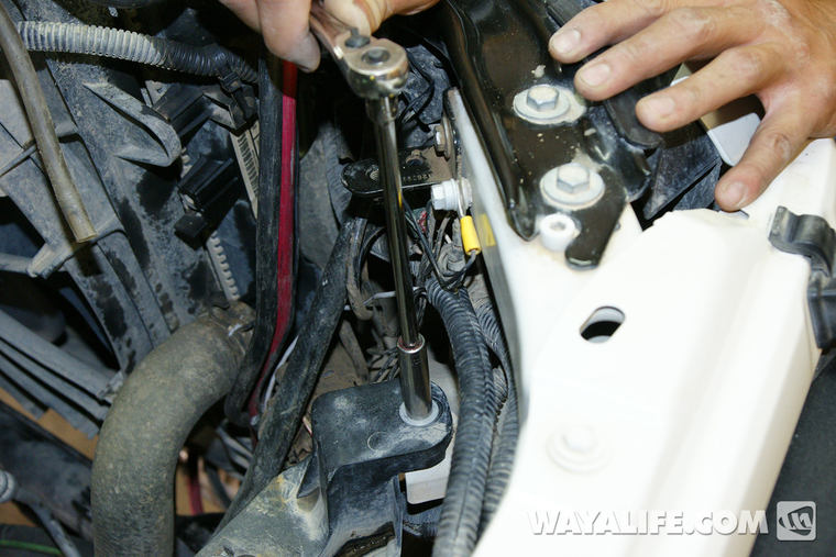

17. Use a 10mm socket to remove the one bolt securing the battery tray to the fender.
18. Use a 10mm socket to remove the one bolt securing the battery tray to the front of your Jeep.

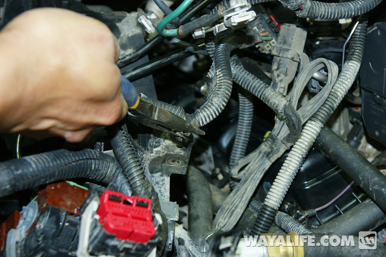

19. Use a pair of needle nose pliers to pry the wiring harnesses off battery tray as shown.

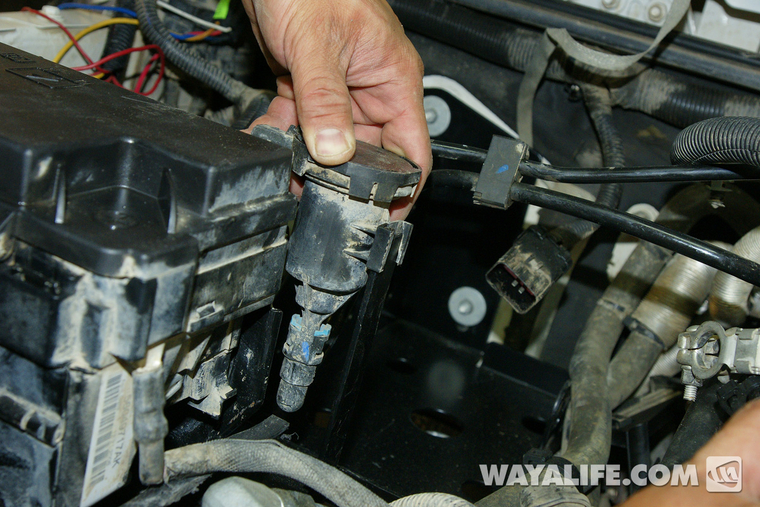

20. Lift the purge control valve off it's mount.

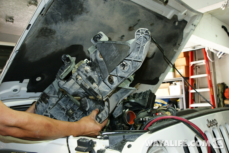

21. Remove the battery tray from the engine compartment.

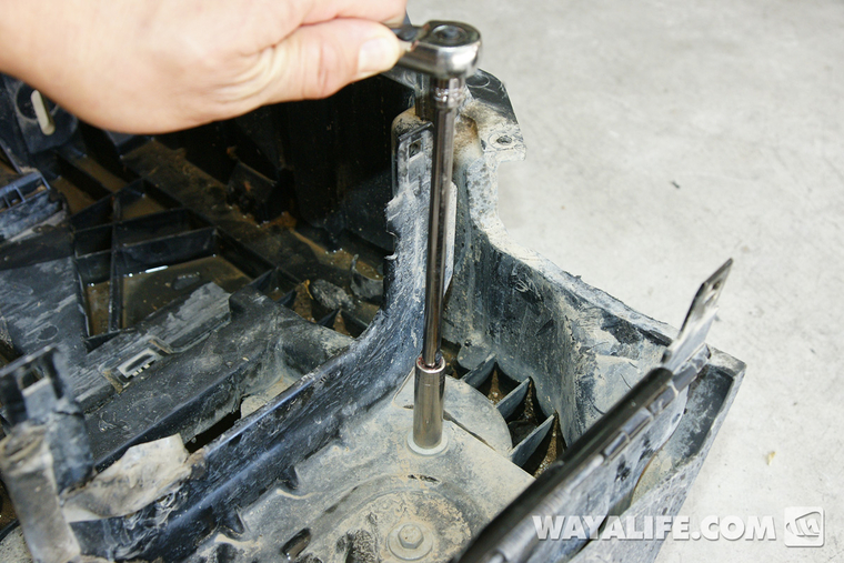

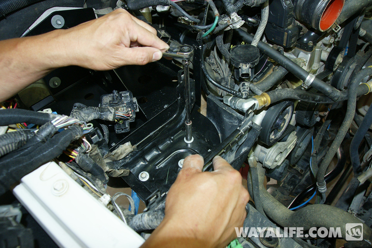

22. Use a 10mm socket to remove the bolts securing the TIPM mount from the battery tray.

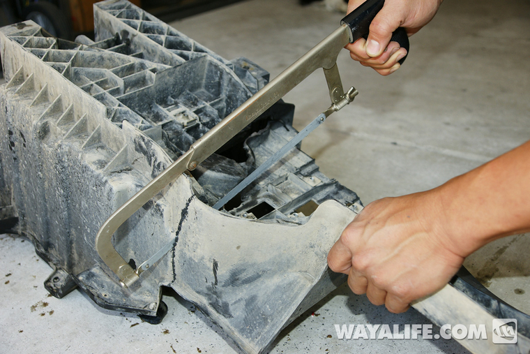

23. Use a hacksaw to cut off the forward section of the battery tray as shown. The 2nd pic shows what you are removing and will be reusing.

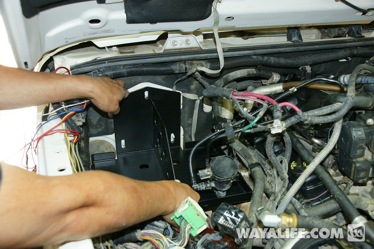

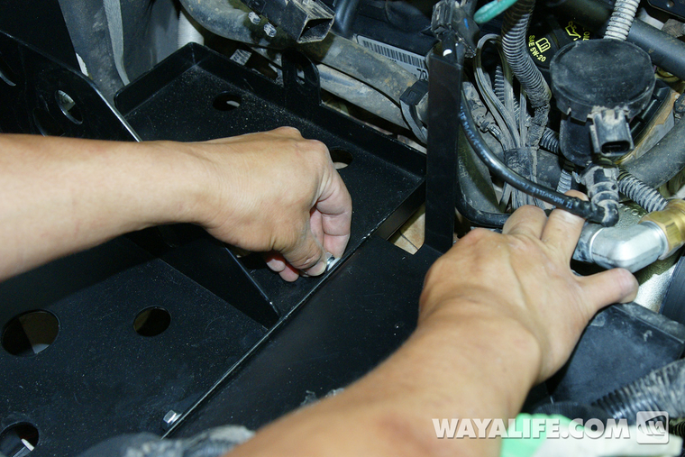

24. Install your new M.O.R.E. battery tray into your engine compartment and align the back of it onto the studs on the firewall.
25. Use the factory nuts to secure the battery tray onto the firewall. Make sure that you do not make the same mistake that you can see I did in this pic and that was to pinch the ground strap behind the tray. You will need to use a 10mm socket for this job.
26. Use one of the factory bolts to secure the only mounting tab located on the bottom of the tray in place. You will need to use a 10mm socket for this job.

34. Install the purge control valve onto its new mounting post.

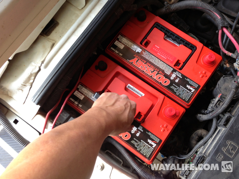

36. Carefully place your new 34-PC1500T ODYSSEY Extreme Batteries into the tray.
37. Place the hold down bracket on top of the batteries and then secure it in place using the J-hooks, washers and wing nuts provided.

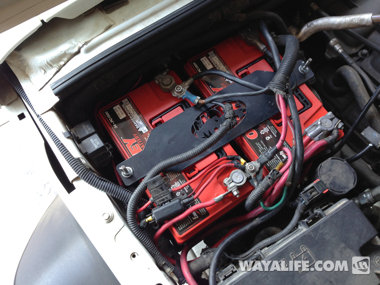

For my purposes, I've just hooked mine up in parallel until I can get around to installing a good dual battery switching system.
And that's it, you now have a two amazing batteries under your hood and can use them from running all kinds of electrical gadgets to using something like a Premier Ready Welder. :cool:
Correct me if I'm wrong but, you seem to be plugued in parallel, not in series.
If plugued in series, you would double the voltage and keep the same amps,
If plugued in parallel, you would double the amps and keep the same voltage.
And, if plugued in series, you would be at 24v, which would blow all your electronic modules
:standing wave:
:standing wave:
You are correct. My mind was on welding - what you see is everything in parallel :blush:
