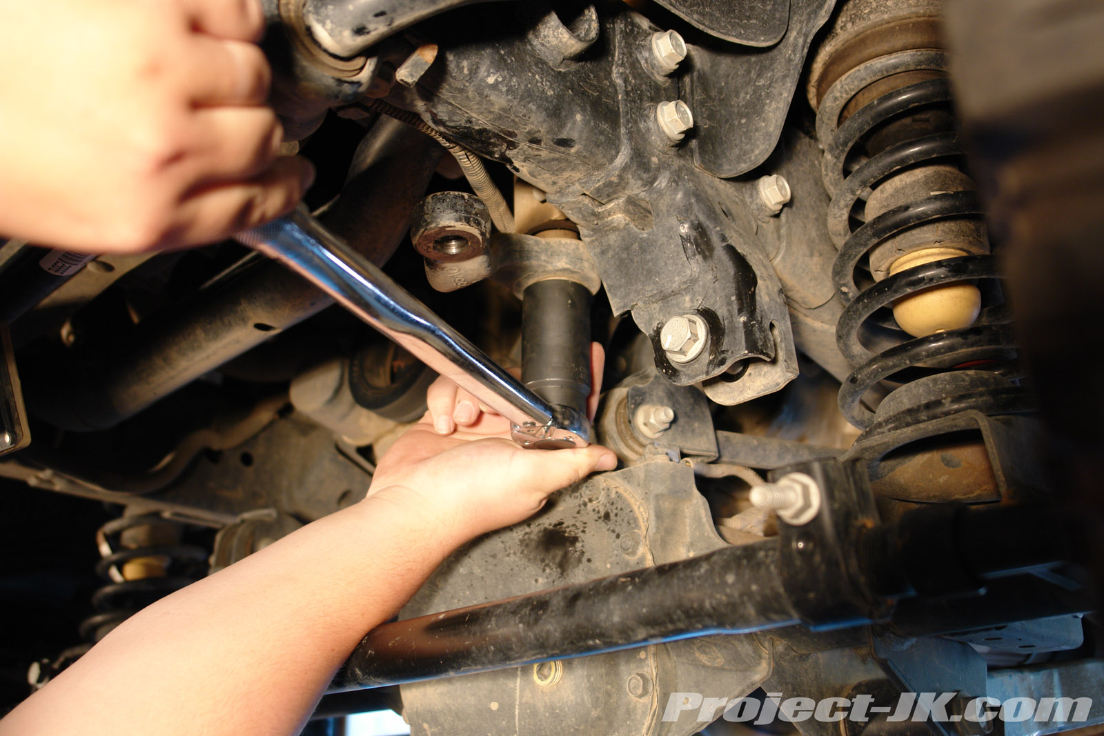

Yea like Eddie said. Just tighten it up by feel, which it pretty tight if you are just using a box wrench. When I swapped my steering box I remember not being able to get a torque wrench on draglink/pitman arm joint. I have a dedicated box wrench (with a slight bend at the head) in that size I keep in my trail tool box just for that nut. I also put a witness mark on the nut and tie rod end so I can see if it moves at all. Haven’t moved since the install and it’s been about 1 year.

My PSC box came with just a lock washer as you can see on the pic. In your case, maybe you needed that flat washer to offset things of a bit. I believe that connection is tapered so that flat washer might have helped with what you needed. Pitman arm nuts are tighter than hell and in general shouldn’t move. Glad it worked out for you [emoji106].
