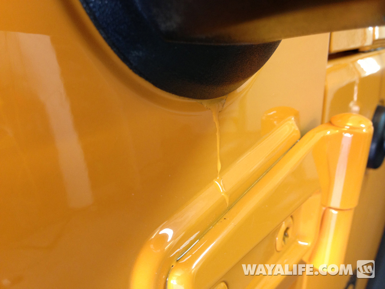

The first Jeep JK Wranglers came with mirrors that had a way of collecting water from rain or being washed and trapping it inside up against your doors - not a good thing. Later JK's saw improvements to the mirrors which included a small notch at the bottom of the flange and, while it did help water to drain out, it was still a bit too small and had a tendency to get clogged up with dirt and debris. To fix this, a bigger drain hole is needed and this easy to do mod will help you to make one.

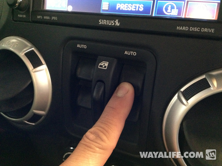

1. Roll down your front windows.

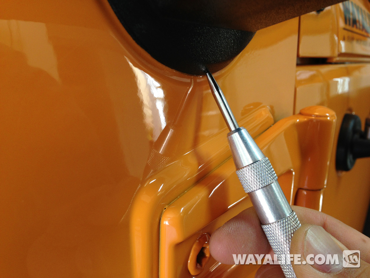

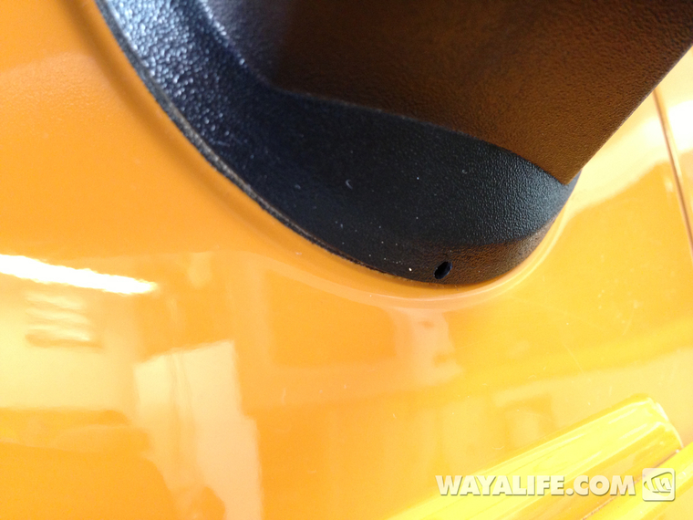

2. Use a center punch to locate the point where you will need to drill a drain hole on your mirror's flange.

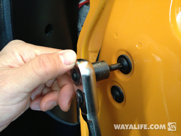

3. Open up your front door and use a Torx T-40 bit to remove the 2 bolts securing your mirror in place.

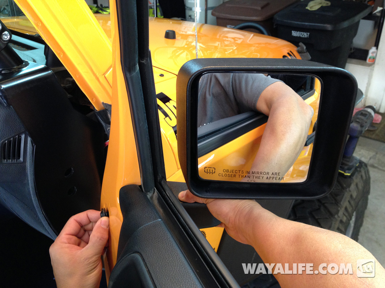

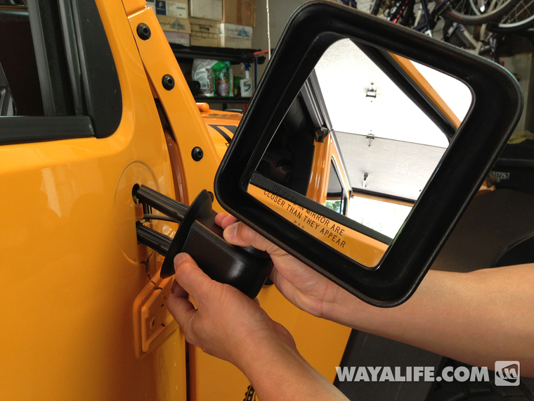

4. Carefully remove your mirror from the door (notice the dirty water that was trapped inside of mine). If you have power mirrors, just pull it out far enough to work on, there is no need to disconnect it.

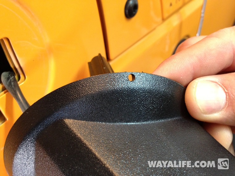

5. Clean out the backside of the mirror's flange and then carefully drill a hole through it at the point where you marked it off earlier with a center punch.
6. Clean out the hole of any loose plastic.
7. Reinstall your mirror and secure it in place with the 2 factory bolts. A Torx T-40 bit will be needed for this job.
That's all there is to it. You now have mirrors that should drain a lot better. Here are a couple of shots of what they should look like when all is said and done.

Hmm... Is it bad that nothing came out of mine? Lol, I'd like to suggest a slight change/addition. I would suggest to actually do two holes. Where the OP made his hole is sitting right up against the foam gasket, so that means that water is going to seep through the gasket first before it gets out the hole. That's not too big of a problem, but like we obviously can see is that debris is actually coming out. Thicker substances such as mud or other debris won't be able to get past the gasket. That's why I'd like to suggest that another hole is made slightly above it. About 1" should be fine. This hole will not be obstructed by the gasket.
Tl;dr: make a second hole 1" above original hole to allow all the gunk to come out.
Thanks for the guide OP!
