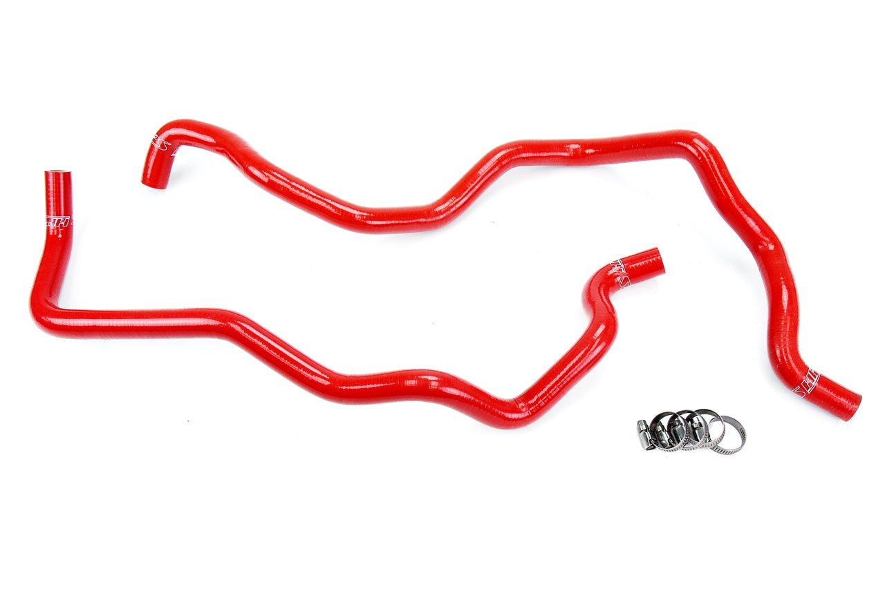

Wow, this must really be an issue on the 3.8 if people are selling these…
185,000 miles on my JKU and it hasn't been an issue.
While I plan on replacing them because of age when they begin to feel a soft, I'll stick with OEM - they don't come with this warning:
"Checking water level regularly is highly recommended when silicone coolant hoses are used in a daily driving vehicle."
Oh shit wow, yea sounds like side effects outweigh the benefits…
Glad yours have held up just fine…
