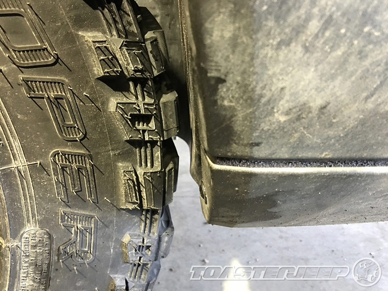

After installing our new 1.5" Daystar Lift and a set of 225/75R16 Cooper Discoverer STT Pro mud terrain tires on our Jeep Renegade Trailhawk, we found that we had a some some minor rubbing at about a 3/4 turn of the steering wheel. After giving things a closer look, we found that the rubbing was being caused by the edge of the front tires making contact with dimples on the plastic fender liners. Apparently, these dimples exist because of a pinch seam located directly behind the liners and if we were going to address the rubbing we had, we were going to have to do some trimming. In this short write-up, you'll get to see where the problem spots are and what you will need to do to do to fix it.

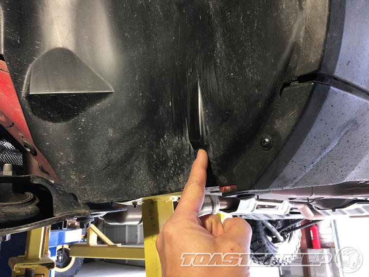

Here's a shot of the driver side front tire right where the edge of it makes contact with the dimple on the fender liner.

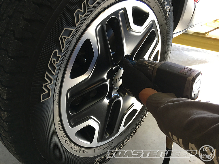

2. Using a 17mm socket, remove the lug bolts securing the front wheels to your Renegade.

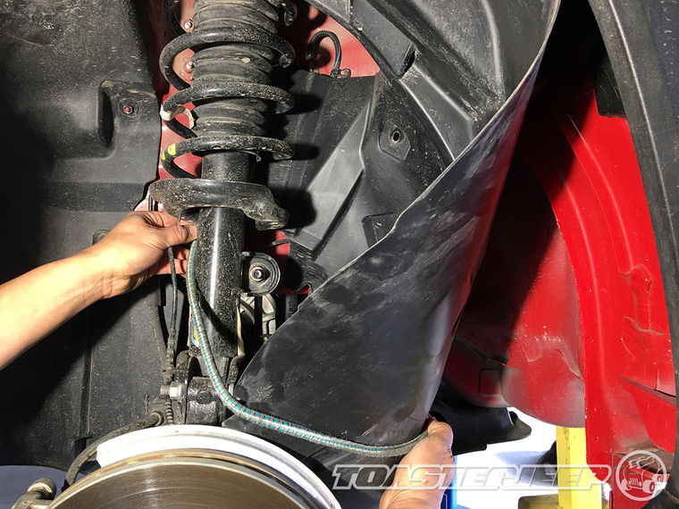

6. Pull the fender liner back then hold it out of the way using a bungee cord as shown.

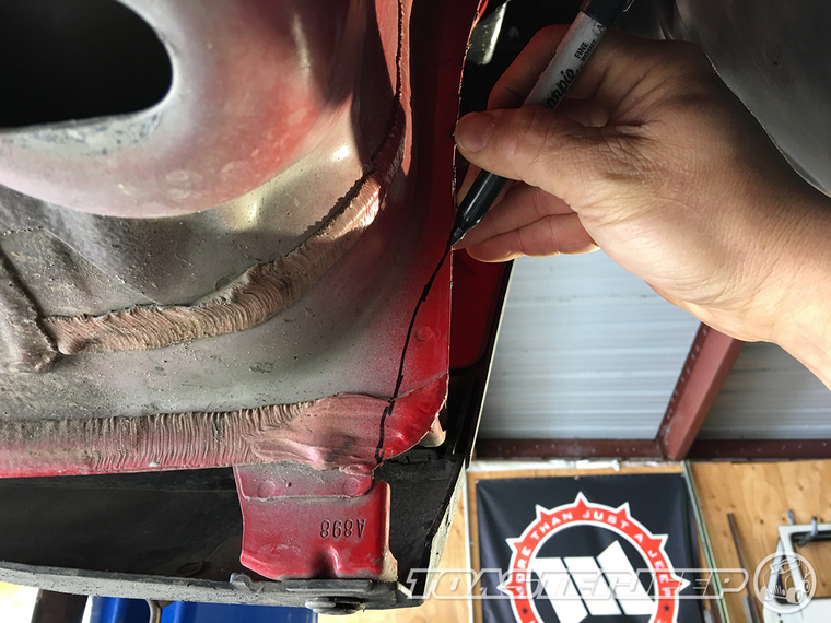

7. Using a marker, draw a line across the corner of the pinch seam where you will be cutting it off.

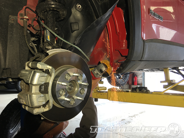

8. Using a grinder with a cut off wheel, proceed to score the corner of the pinch seam where you drew your line.

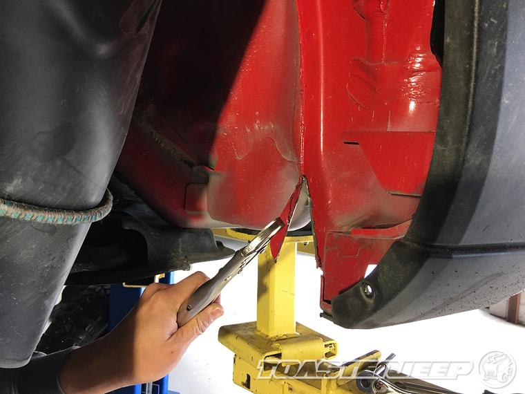

9. Grab the corner of the pinch seam with a pair of vice grips and then work it back and forth until it breaks free.

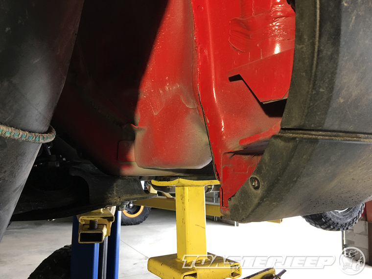

10. Clean up the rough edge with a flap disc or flat file and then touch up the exposed metal with some chassis paint.

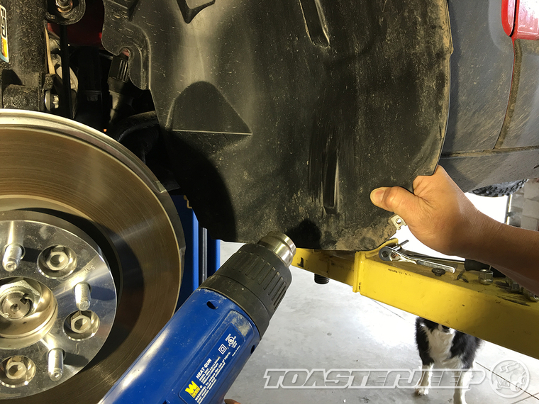

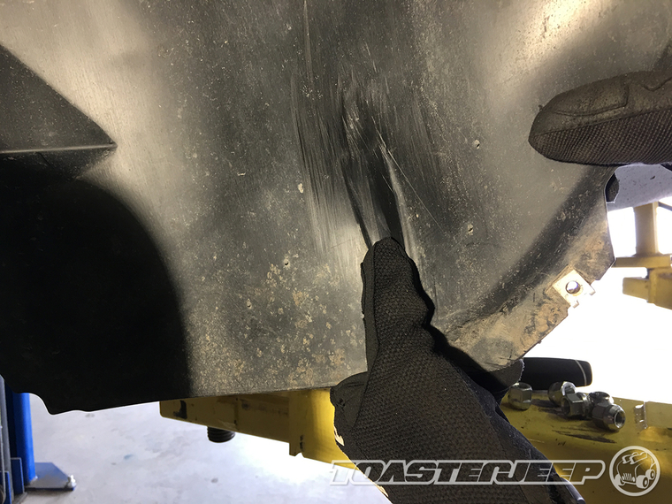

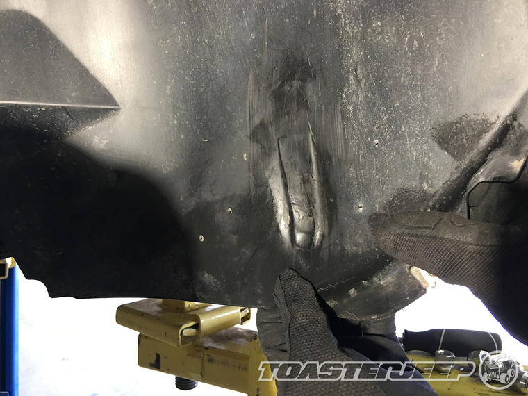

11. Release the plastic fender liner from the bungee cord and then soften up the dimple by heating it up with a heat gun as shown.
12. Once the dimple in the plastic is soft enough, press it inward. Being that the plastic will be very hot, you will need to be wearing gloves when you do this.
13. Repeat steps 11-12 until the dimple is effectively sitting concave to the surface of the fender liner.
