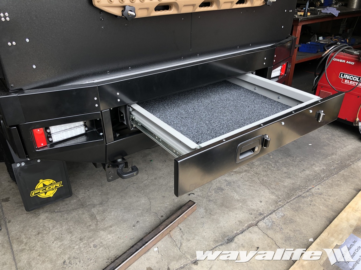

A few shots of the drawers and cubbys on this thing.
