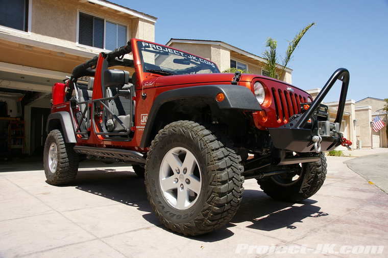

I'd still like info on the picture of the Jeep i posted up on page 1. mainly what size tires is on that jeep and what lift (make and size)

BUT the build sheet, i think, is at the jeeps final stage and says nittos. I believe the tires in the pic you posted are goodyear mtr KEV 35's. I cant zoom enough to see clearley in the pics though. I cant speak on the lift being used but It looks like 2.5" to 3.5".
And as stated previously you can easily go with a 35" tire, 3" lift, gusset your factory axles, and use your stock rims and be done with your build. picking which of all those parts would be up to your preferences and what you will be taking your jeep through.

Here is the thread on Jk-Forum about the lift and tires on Nemo at the time the pic was taken..
http://www.jk-forum.com/jk-show-tel...o-stage-1-ome-long-travel-kit-35-mt-rs-90536/
It is a 3" OME Long Travel Kit & 35" MT/R's
