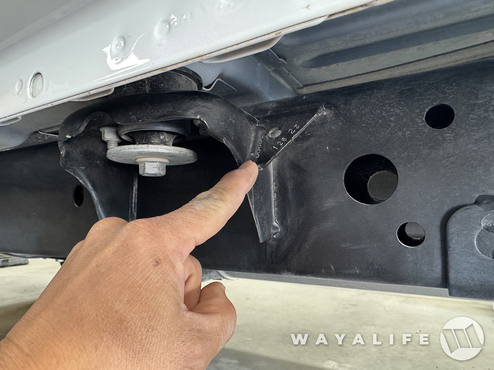

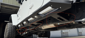

First and foremost are gussets on the middle body mount that get in the way of the rock slider mounting arms.
These are not present on a JL Wrangler and do need to be trimmed along with the flares on the mount in order to get the rock sliders installed.
I don't know if there was a change in 2023 or what but the other issue I came across was that the bottom of the rear most rock slider arm mount sat a bit too high and once everything was secured in place with the factory bolts, the rock sliders looked visibly sloped down toward the back. And yes, I know the body is curved and that is part of what I was seeing but even getting it on was kind of a pain and I almost felt like the slider was bowing a bit.
I tried really hard to make things work and even used washers to help level things out and while it did help, I really didn't like that as a solution being that I was correcting a majority of the mounting points to address a problem that just one was creating.

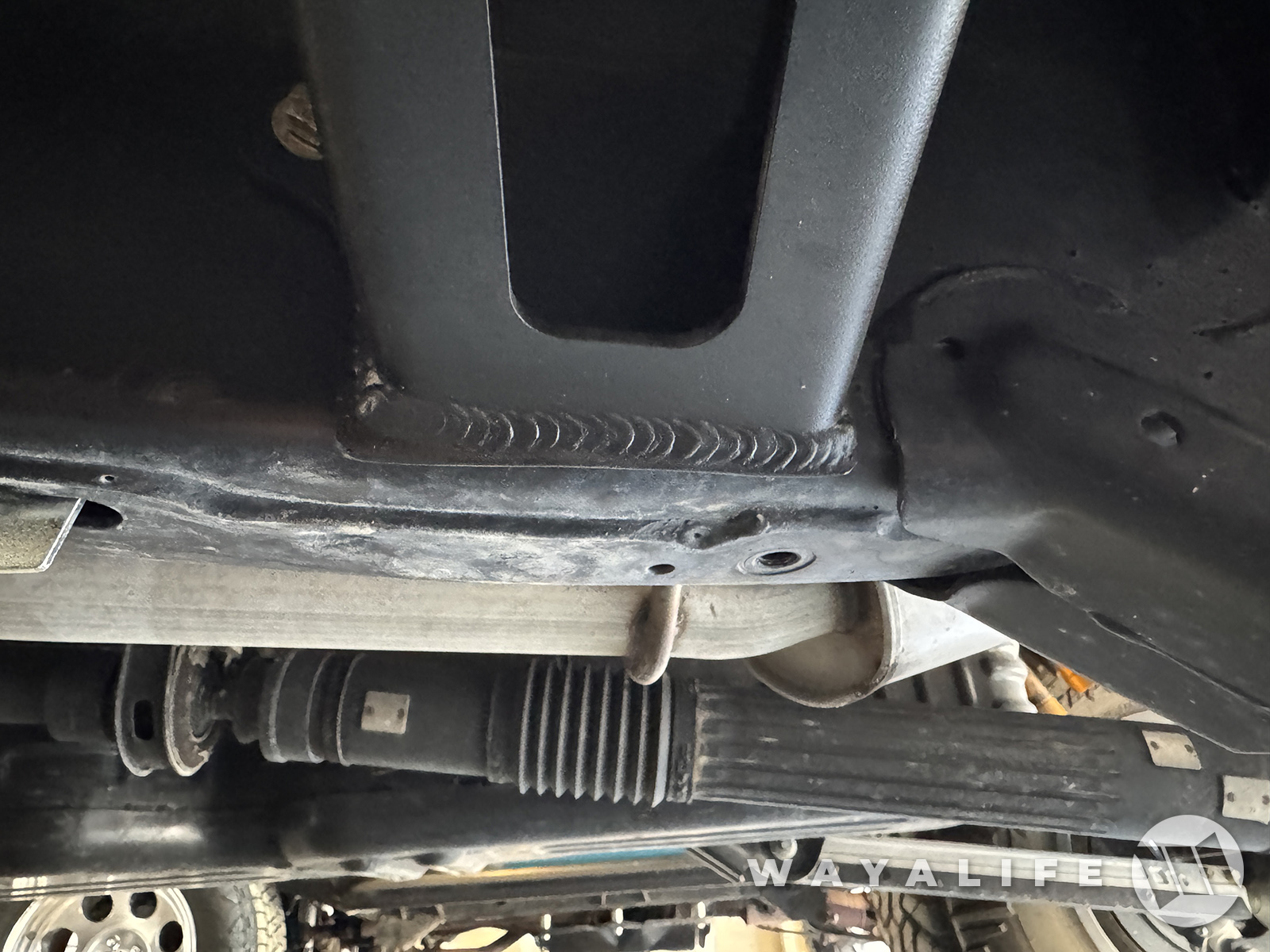

So, what I chose to do instead was cut off the base of the rear most mounting bracket so that it would no longer pull it downward. And, this did the trick. I should note, there are still 2 holes on the side of the frame rails that you need to drill to secure the rock slider to it and I was much happier about doing this once the rocker guards looked straight. I figure, if needed I can always weld the base of the slider arm mount to the frame rail.
And, in case you're wondering, yes, this was an issue on the passenger side as well and one that required the same fix.

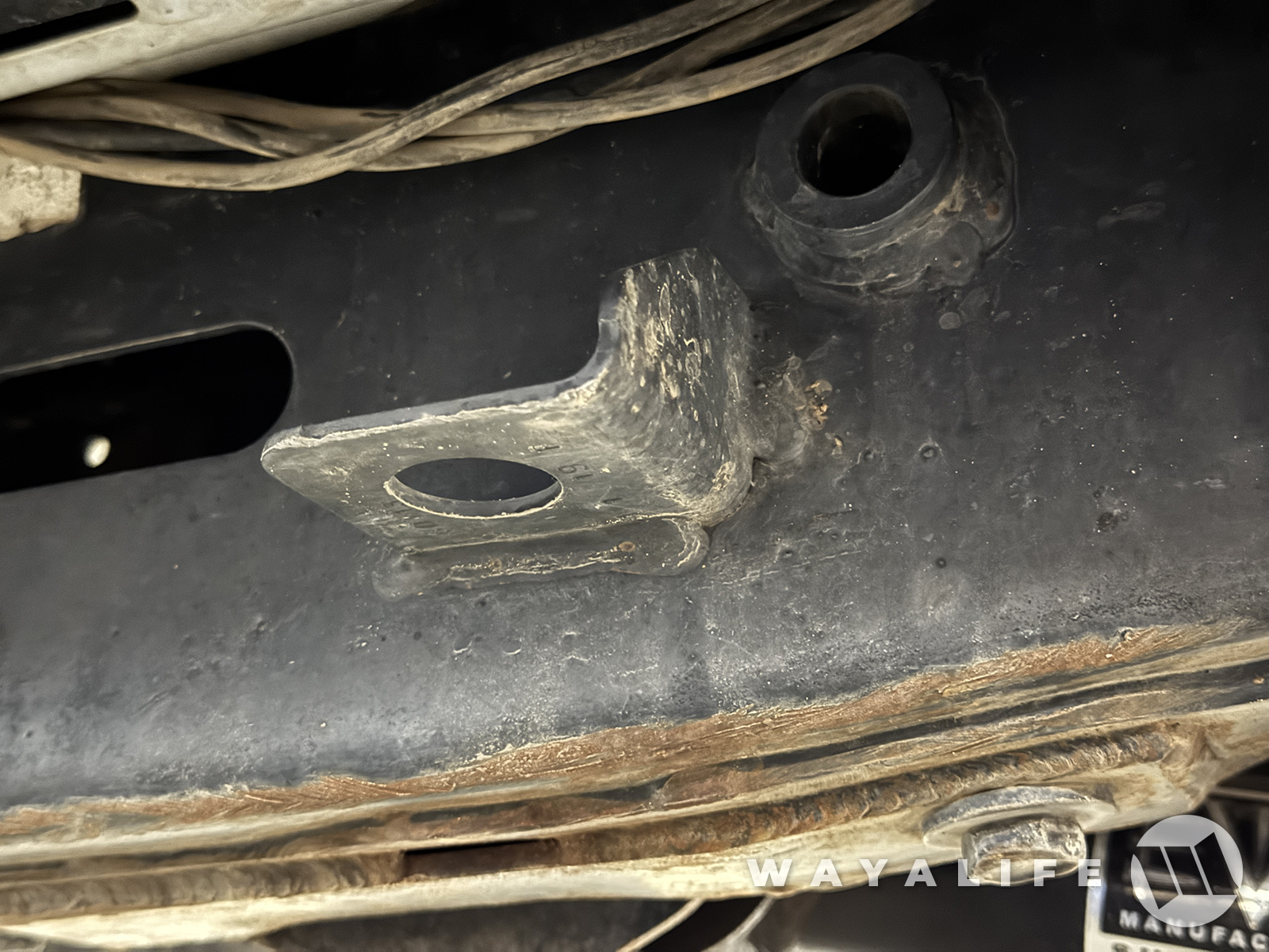

Finally, there was one other thing that I encountered and wasn't expecting and that was a factory L shaped bracket that's located close to the forward most passenger side rock slider arm mount. Again, this was not something I had to address on my JL Wrangler and it needed to be cut off in order for the slider mount to sit flush with the frame rail.

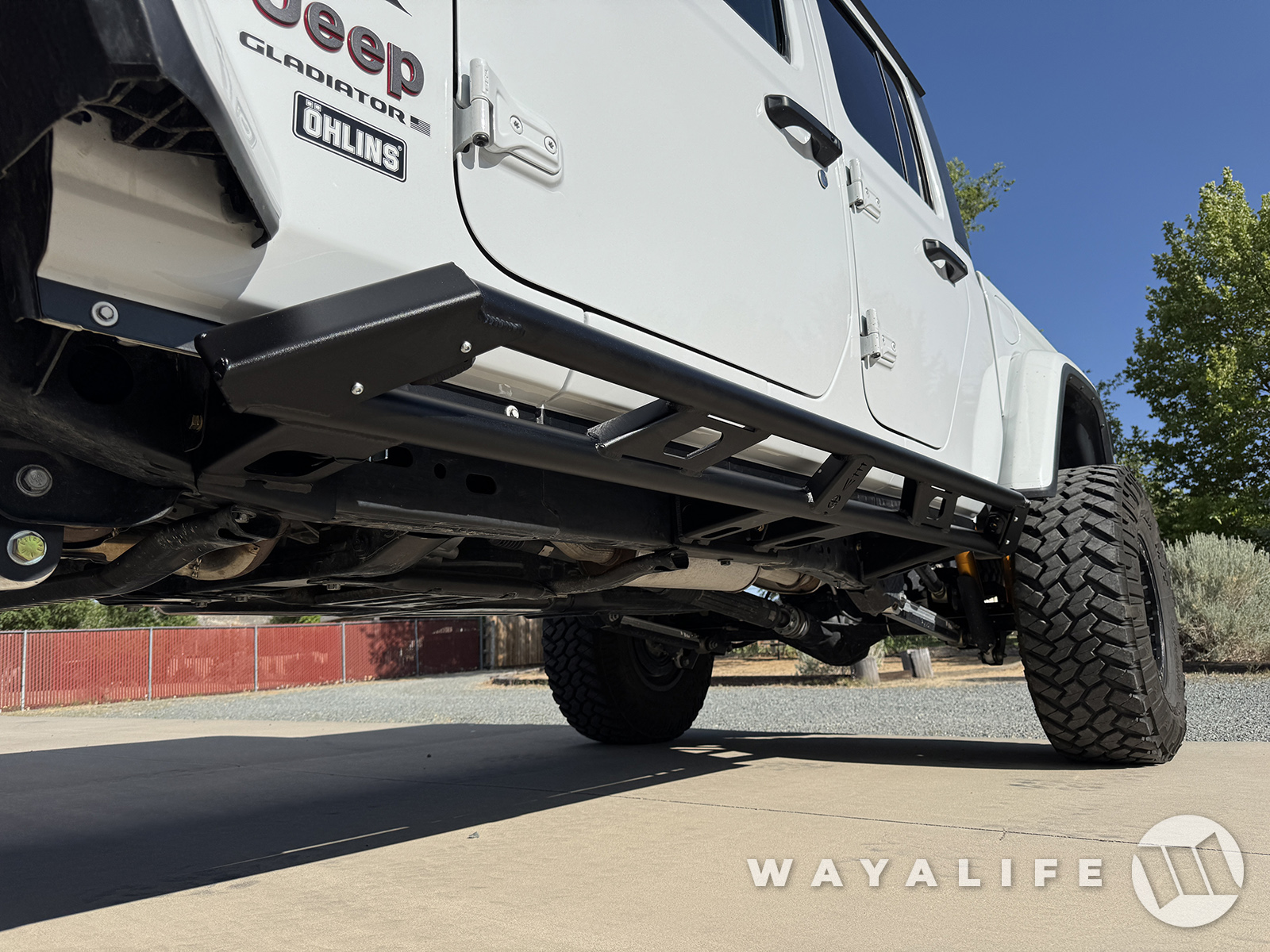

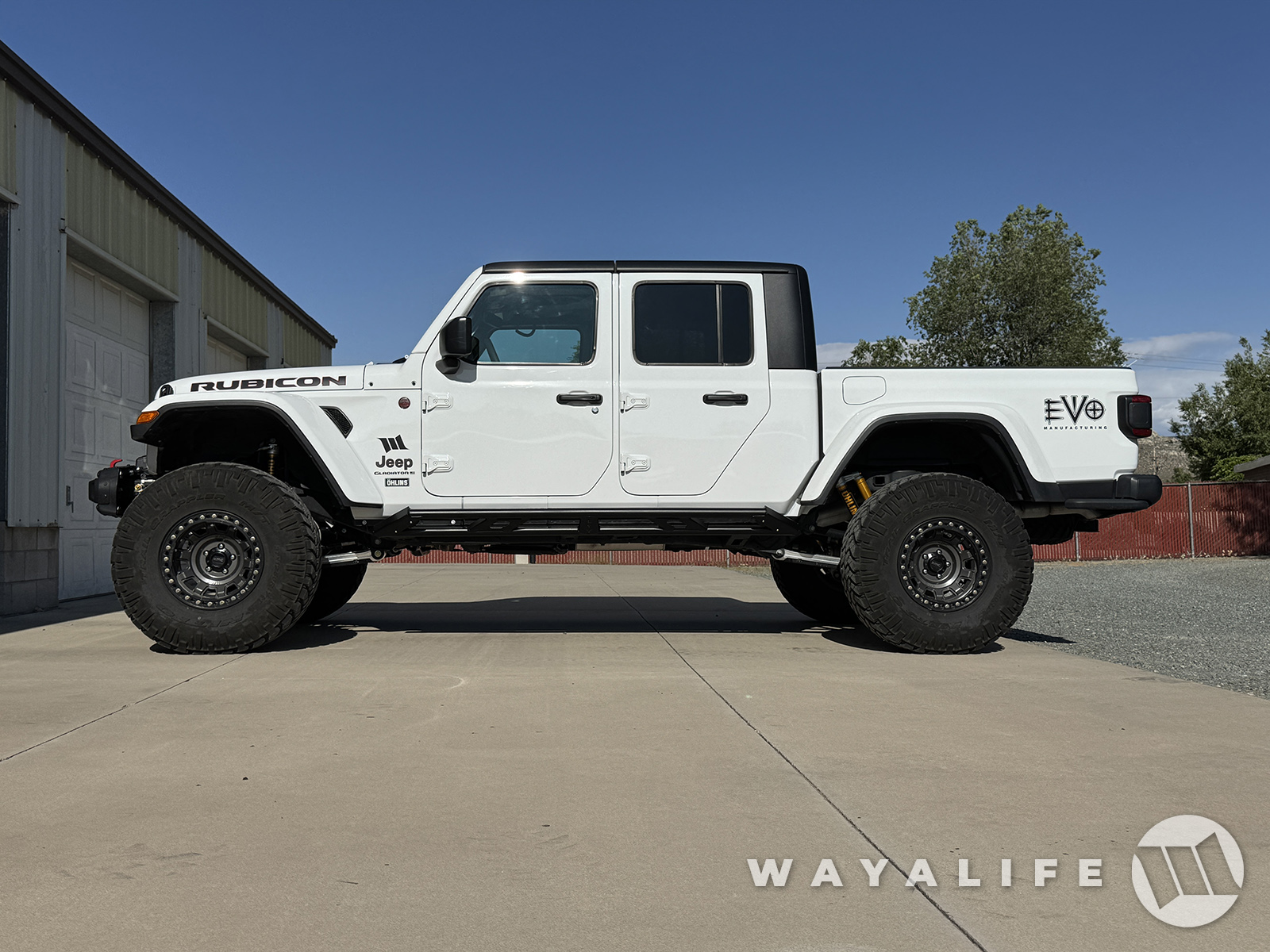

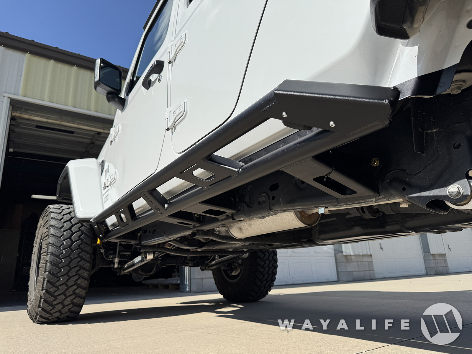

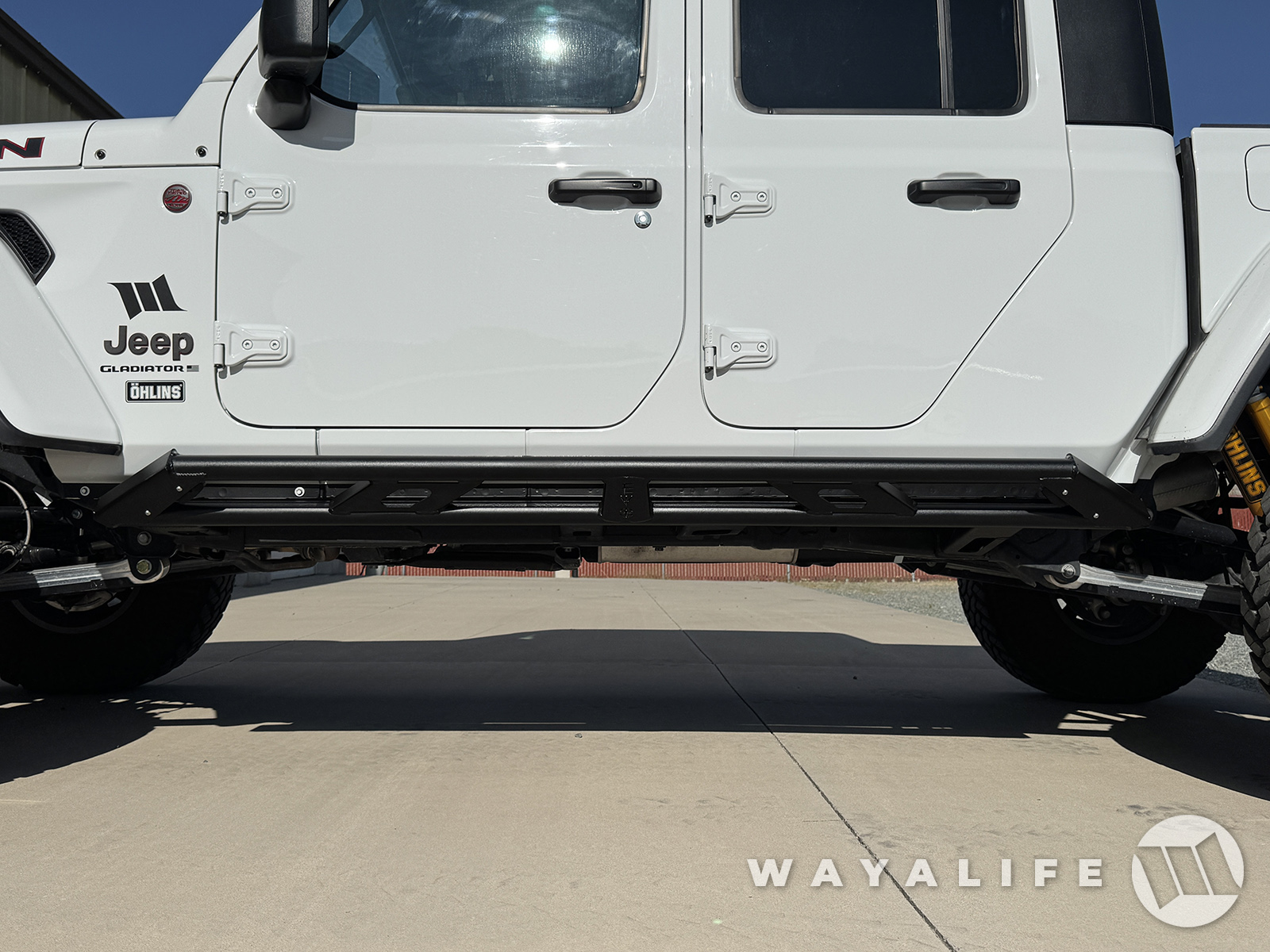

With all that said, here are a few pics of what the EVO Rock Sliders look like installed on our Jeep Gladiator.
