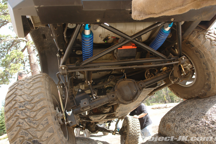

Pics of these mounted on the rear of someones jK would be helpful. Thanks guys.

They mount outboard on the rear with the nuts on the inside with a washer.
A quick Google Image search should reveal enough. I know these are with a DTD but shouldn't matter I don't think. Running mine on the outside.

Easy enough. Thank you, Aermotor
^ yes, they should run like this also with stock rear swaybar. Make sure to measure eye to eye for your correct lift height.
If you are running your brake lines on the outside, you may want to consider re-routing so as to not snag when flexing.
