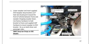

For the rear the instructions show installing a sway bar drop bracket to the frame. The kit has no such part, nor is it listed in the parts list. I can't find one on the EVO website. How necessary is dropping the swaybar?
It's not critical to have. If you plan on doing a lot of big flexing on the trail, it will help to prevent over extending your links and potentially have them invert. That's all.
