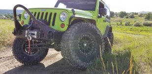

So nice! In one pic it looks like the front EVO sway bar link is bent. Is that just the picture or is it supposed to be like that?
GCM 2 said:The EVO links all have a slight, intentional curve designed into them. It keeps the link away from the coils during the suspension's traveling cycle.
