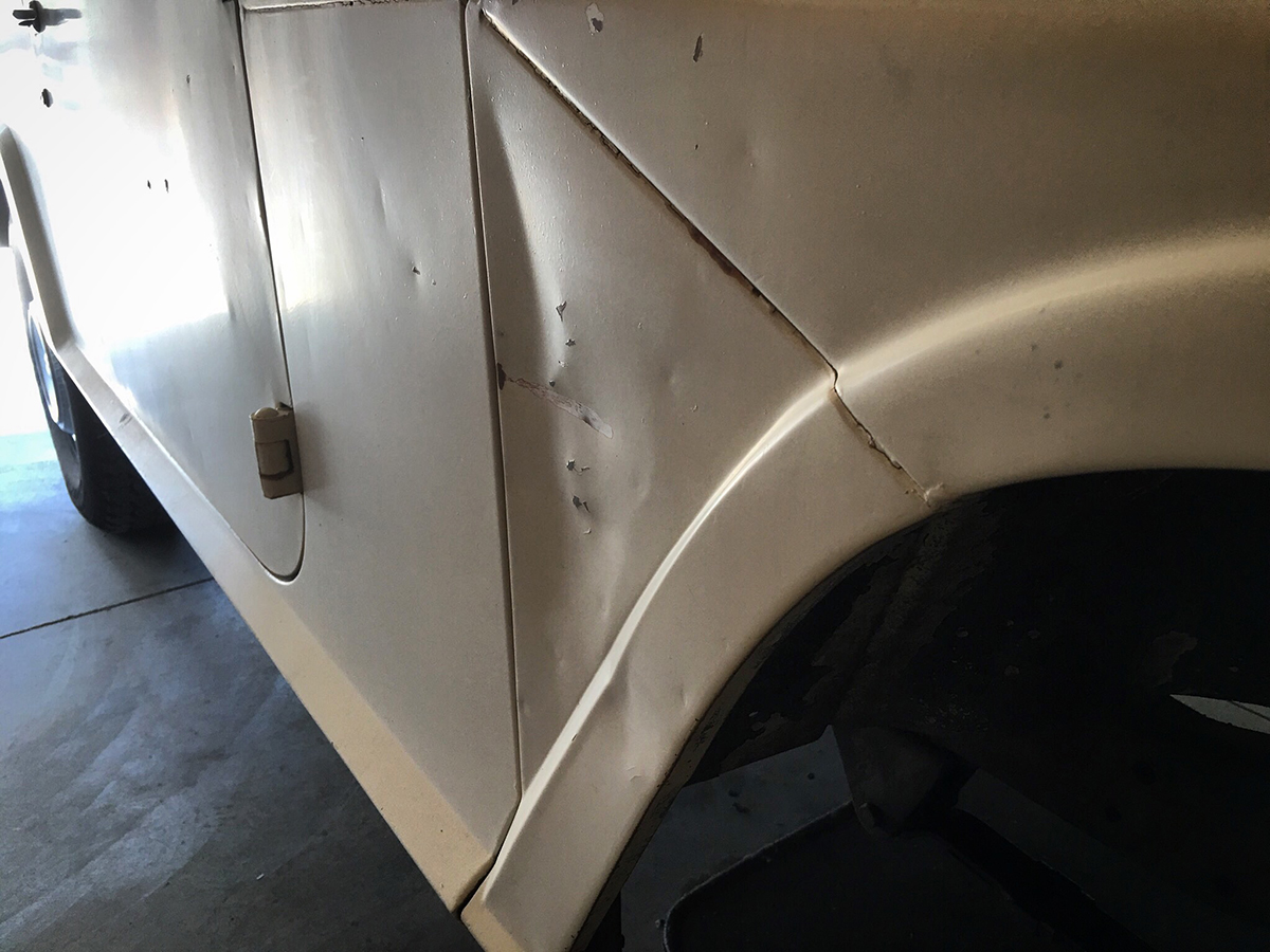

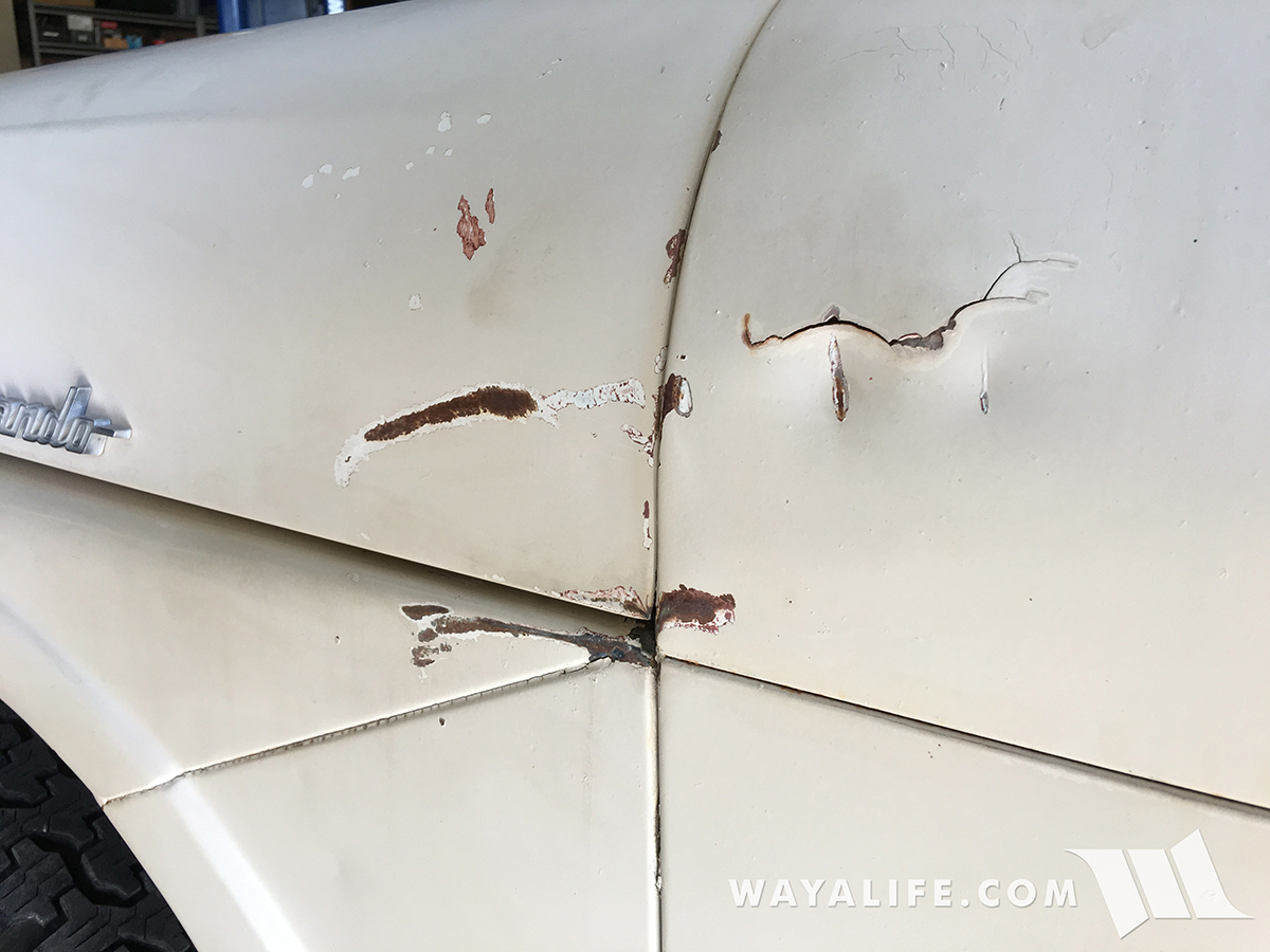

Here's a shot of the dent she had on her passenger side front fender. Or, what I called a smile line in her cheek.

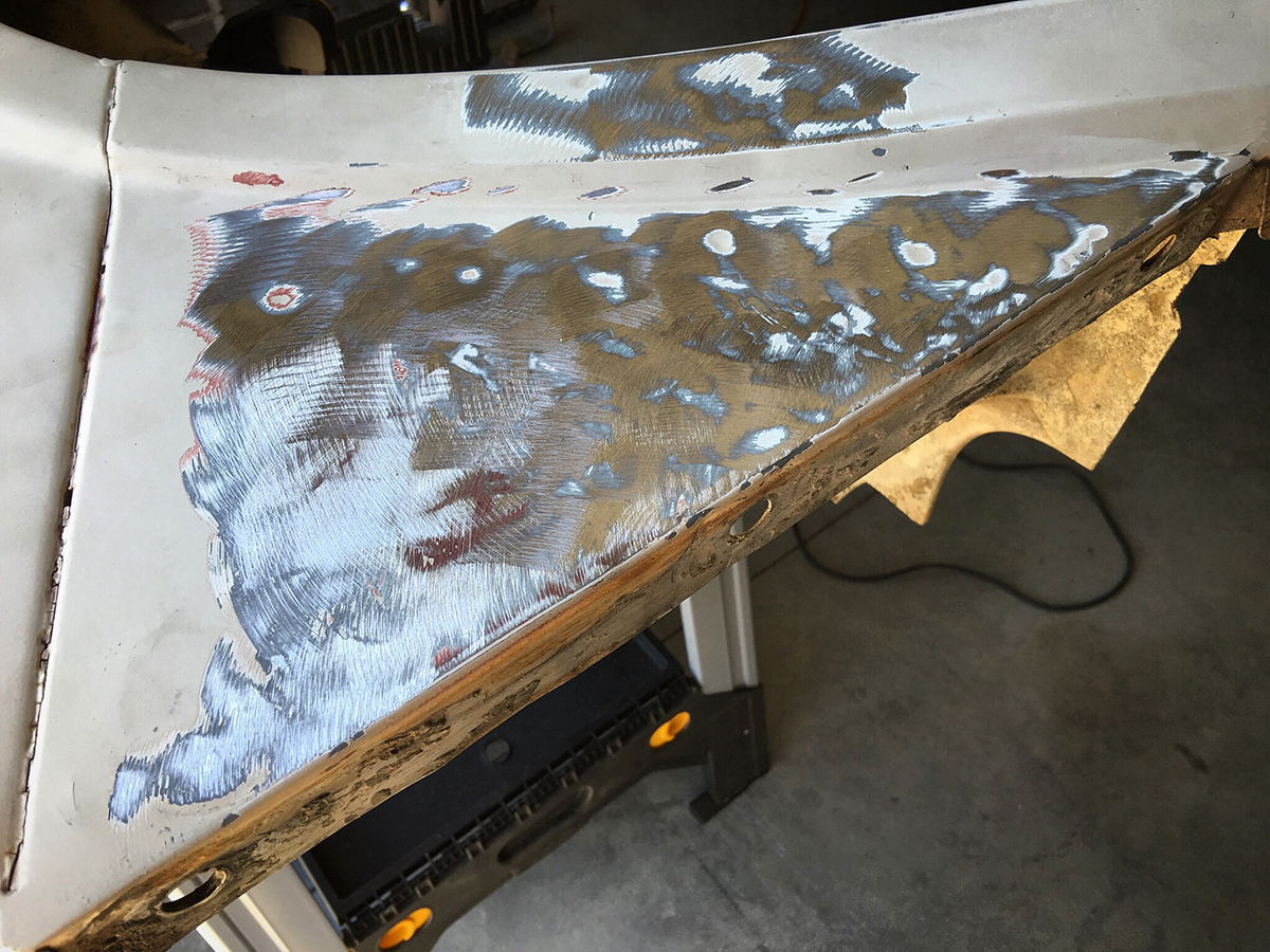

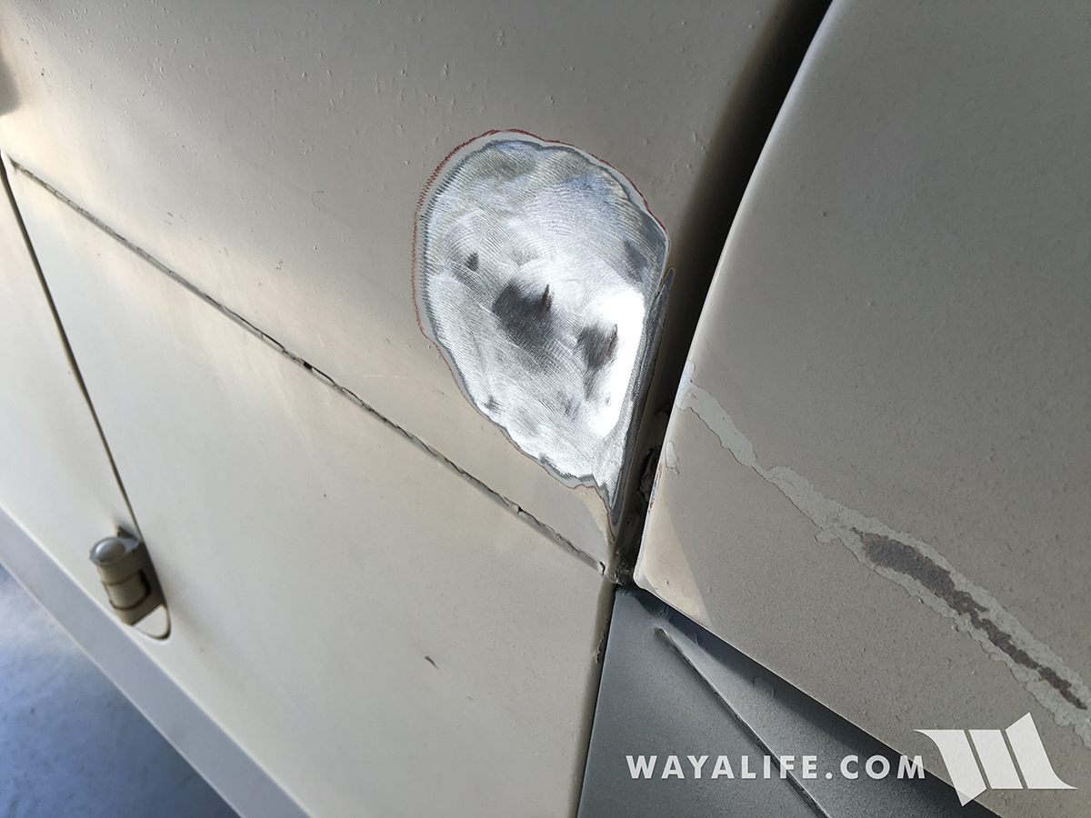

Fortunately, it's really easy to remove the fenders on a Jeepster Commando or really, any CJ for that matter and that makes pounding out the dent with a hammer and dolly so much easier. Here's a shot of what the dent looked like after massaging out the wrinkle and sanding everything down with a 36 grit sanding disc.

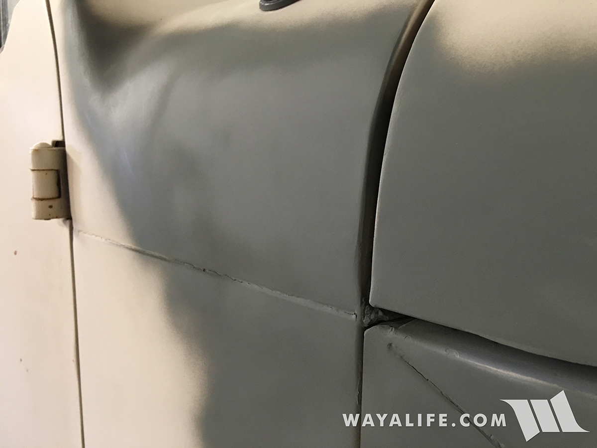

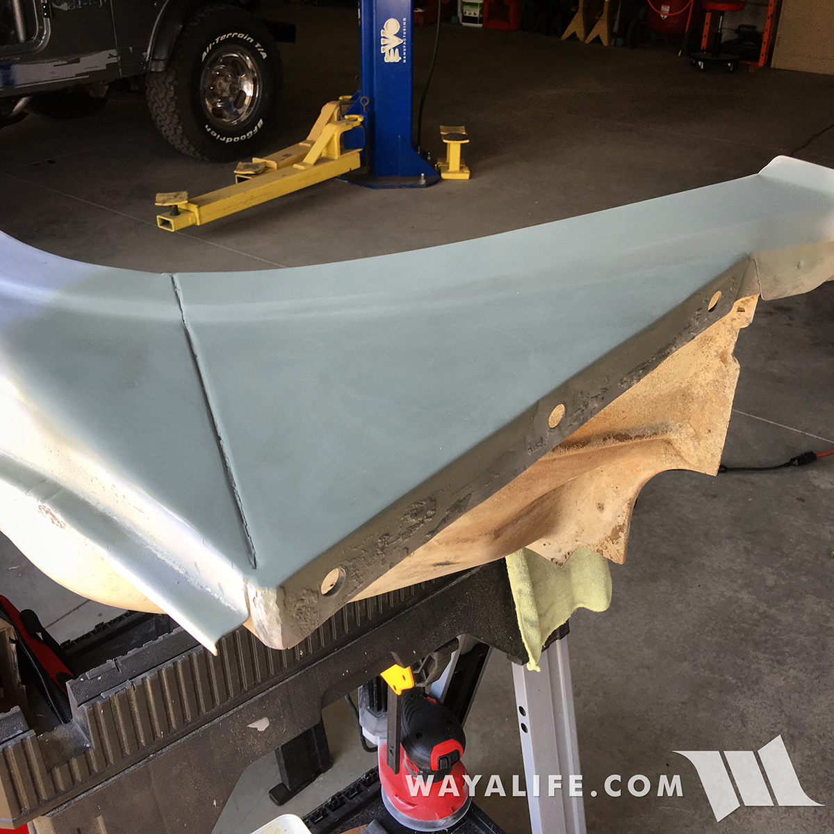

After apply some skin cream, smoothing things out and applying some foundation, I think her cheek is looking more youthful again.

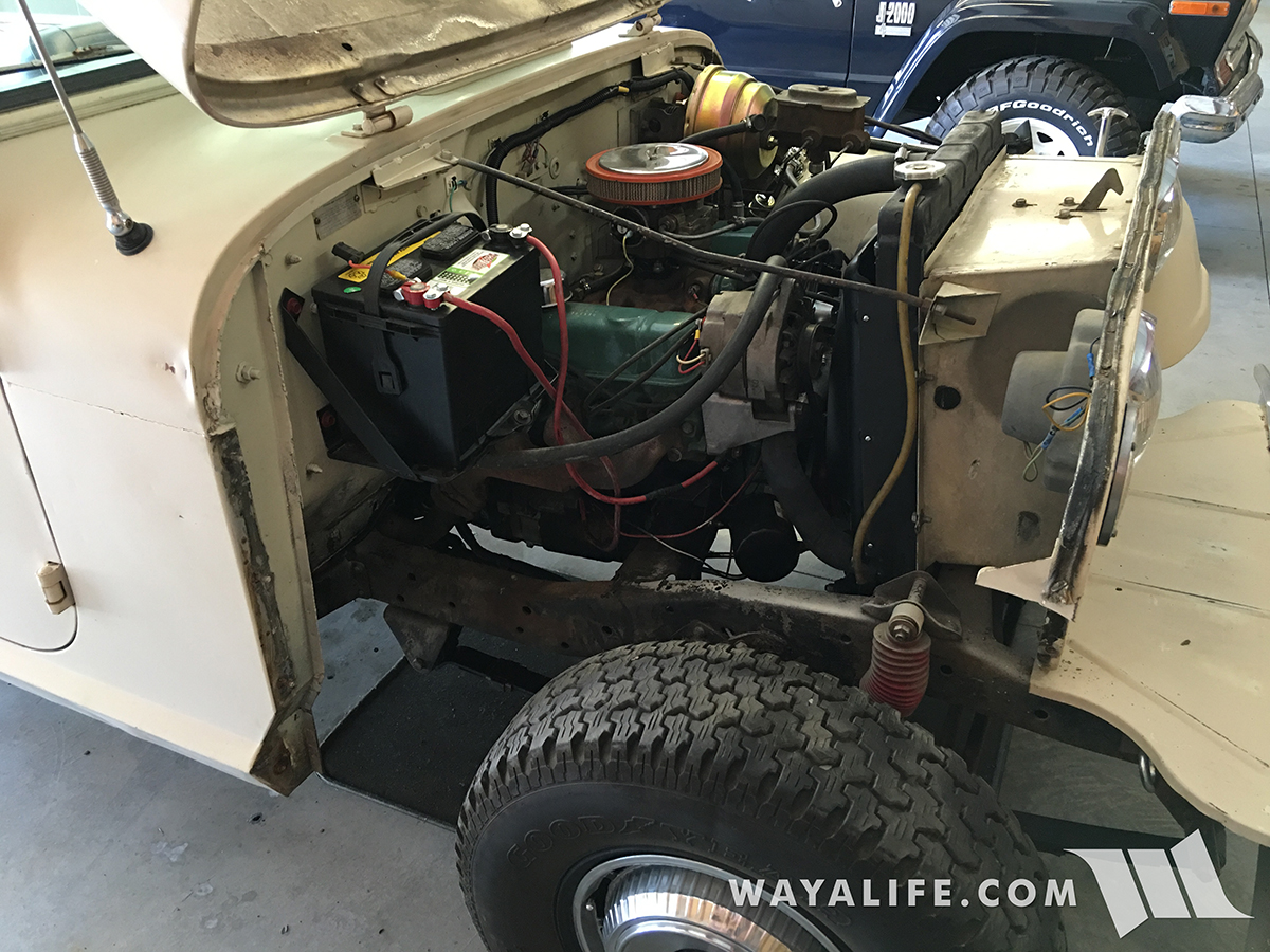

I did break a mounting stud trying to remove the fender and will have to weld a new one on before I can reinstall things but I thought I'd post up what I've been able to do so far. I still have a bunch of holes that I want to fill in and the rocker panel on the driver side is going to be a real challenge to pull out being that there's no access to it from the back side. But, I hope to post up my progress on here as I address each wrinkle and age spot. :cool:

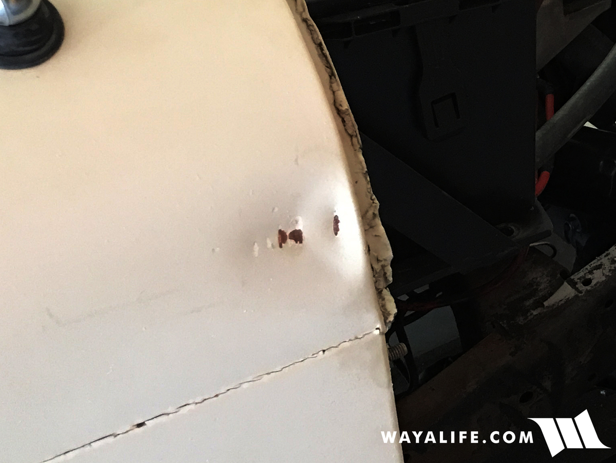

The dimple on the passenger side cowl wasn't too bad but was still deep enough that I wanted to have it pulled out.

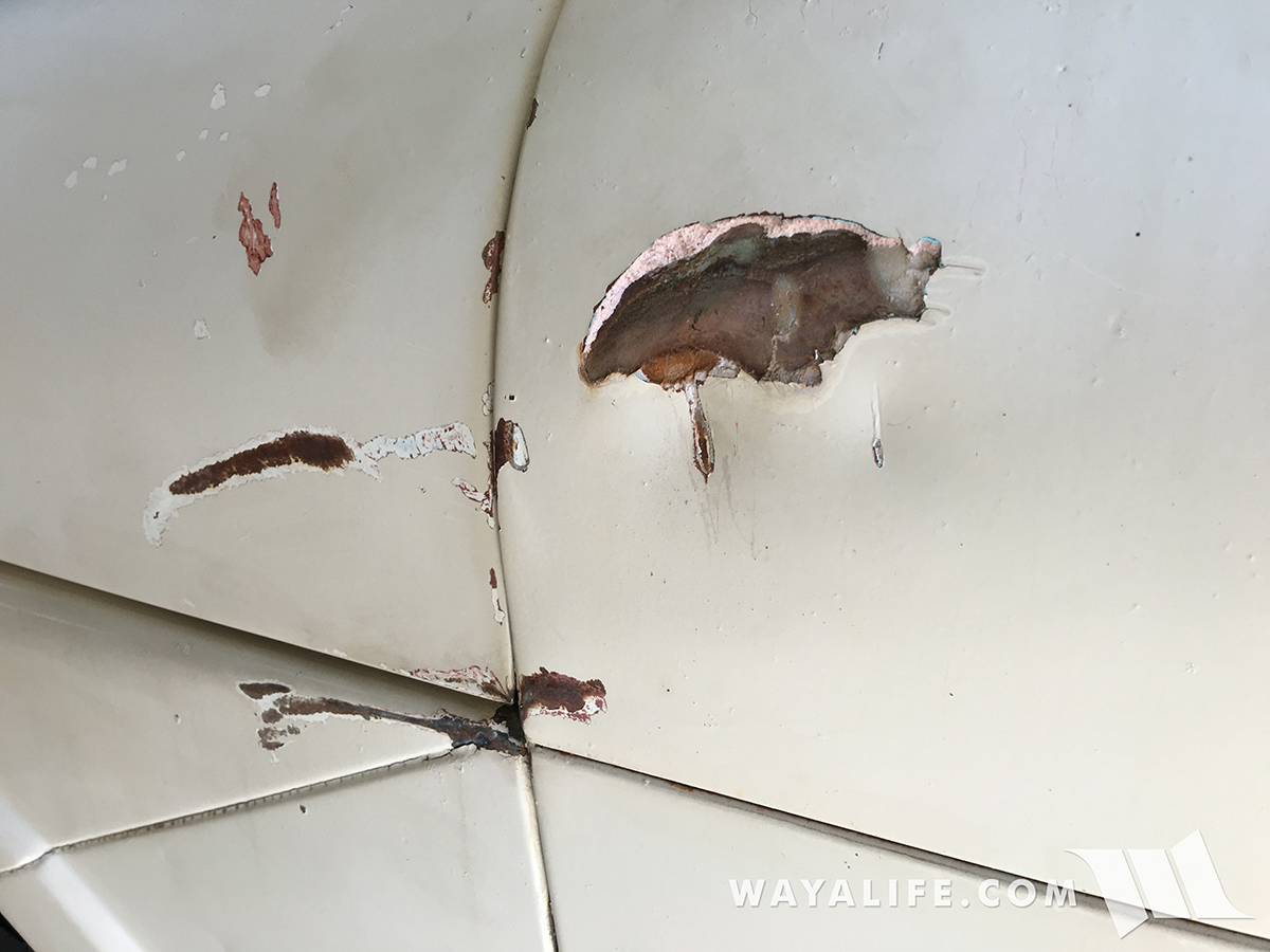

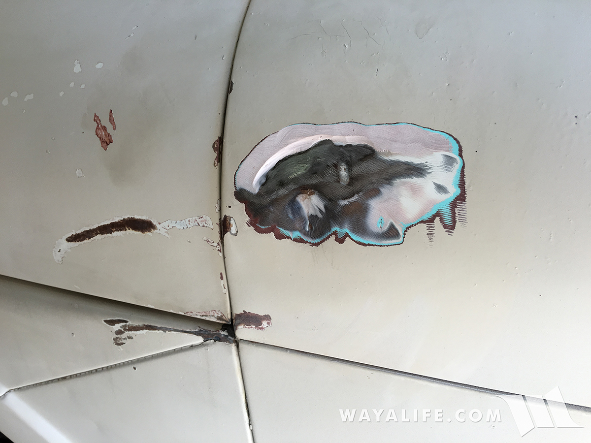

On the driver side, it was pretty clear that Emma not only had her cowl hit hard in the past, it had been repaired once before and then hit again or maybe even a few times since.
Chipping away at the old bondo reveled the original dent was pretty deep.

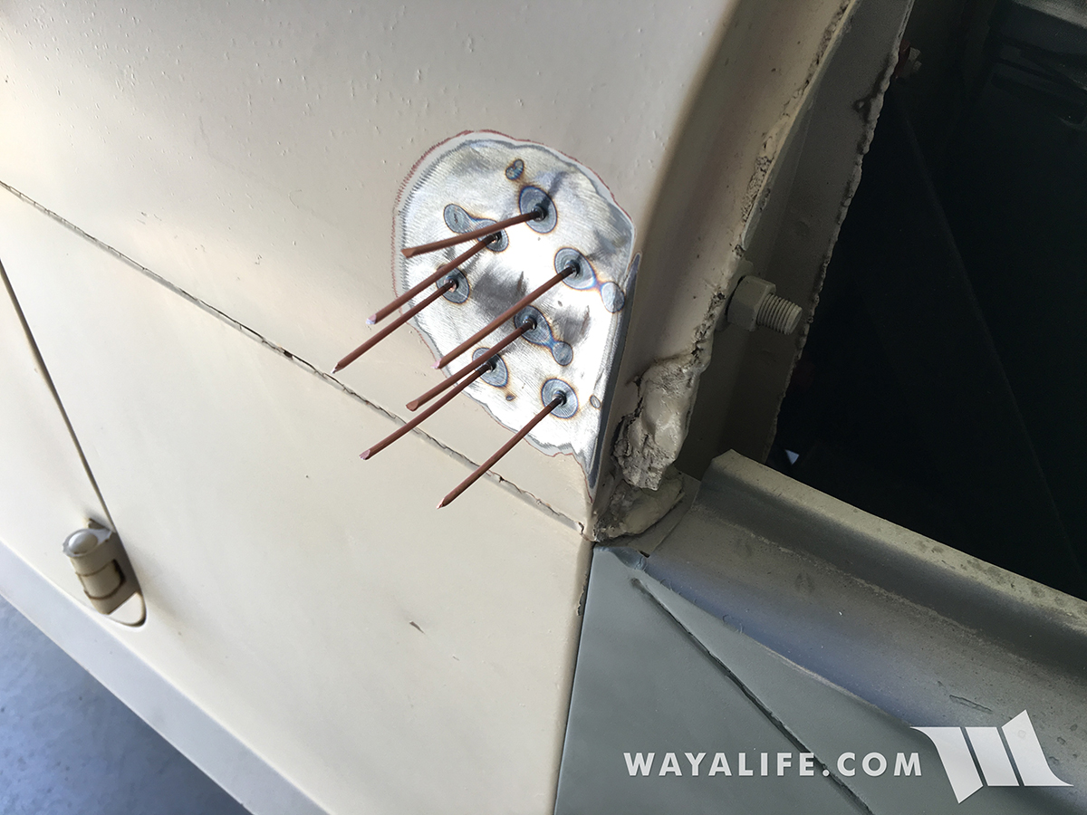

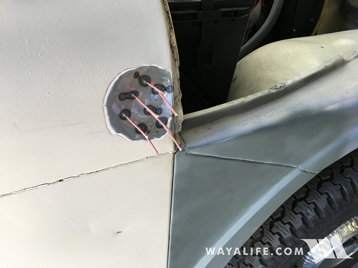

Applying stud welds to the affected area.
Using a slide hammer to carefully tap the surface back out, the results are looking good.

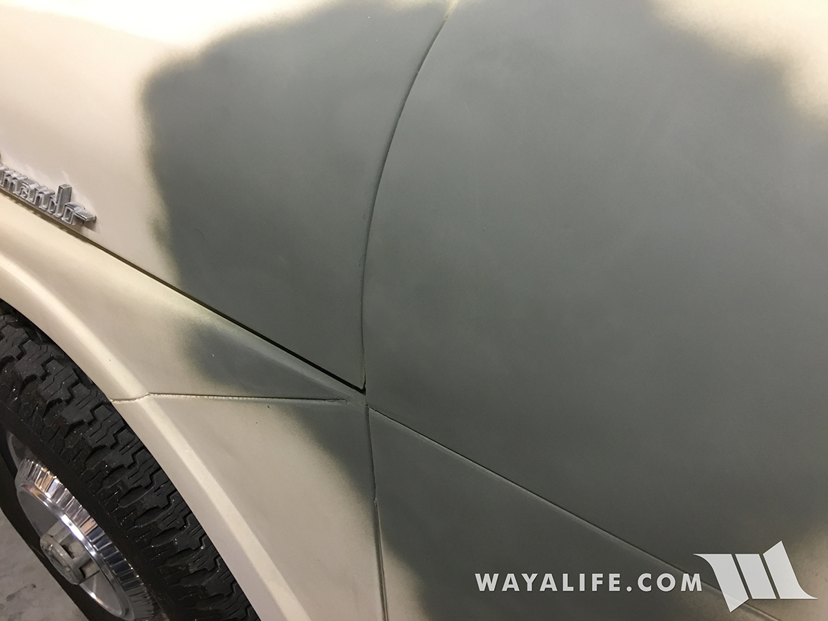

After applying a little skin cream, smoothing things out and applying a bit of base makeup, here's what her cowls look like now.
Here's a shot of both the repaired fender and cowl on the passenger side.

Looks good so far! I don't know if you've seen these before, Seems like this little doohickey would be good for rockers, or other panels with no real good access. Many years ago I sold auto body paint and supplies, I've never used one but it spot welds a pin to the panel, then use the pin to anchor a slide hammer, when done grind off the pin. Hope this helps.
http://m.harborfreight.com/stud-welder-dent-repair-kit-61433.html?utm_referrer=direct/not provided
LOL!! Actually, I have one of these and will be using it to help pull out the dent in the rocker panel. It works surprisingly well :yup:
