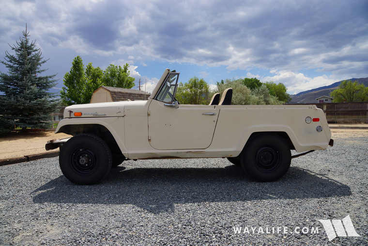

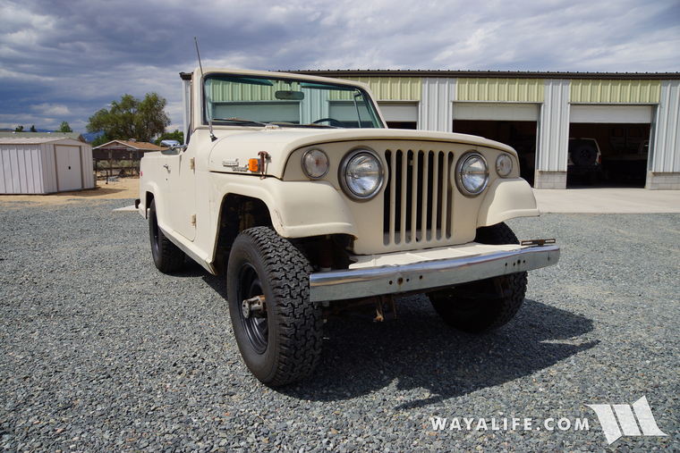

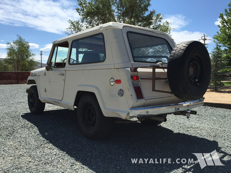

Hey everyone, Cindy and I would like to introduce the newest member of the WAYALIFE family - a 1969 Kaiser Jeepster Commando, also known as a C101 due to it's 101" wheelbase. As you can see in the photos below, this old lady is still bone stock and if you can believe it, still running the original 160 horsepower Dauntless V6 engine and TH400 automatic transmission. While she does have a few bumps and bruises and even a touch of body cancer in the passenger side rocker panel, she is overall a very clean Jeep and one that we look forward to working on. Of course, the best part is that we were actually able to driver her home, on the highway and safely at speeds over 65 MPH!
Anyway, here are a few pics that we took soon after brining her home. :cool:

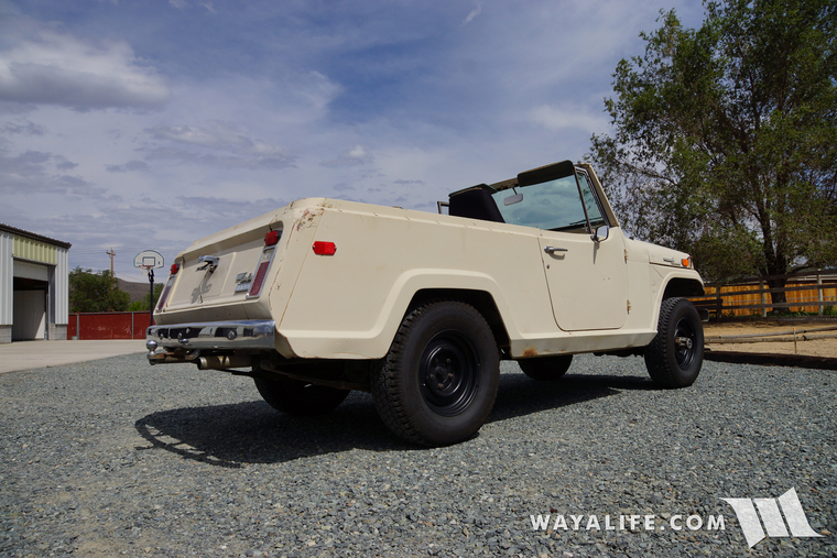

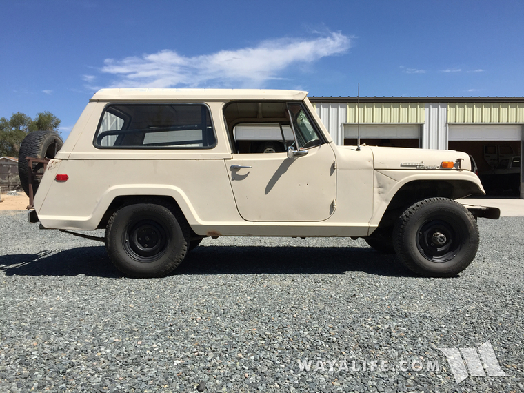

Here you can see some rocker panel damage on the driver side of the Jeepster that might be tough to pull out. Fortunately, if needed, replacement panels can still be found.
There's also a dent in the driver side rear quarter panel but, I think I can get this one straightened out without too much fuss.

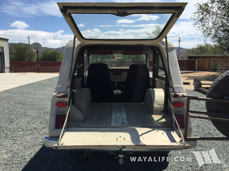

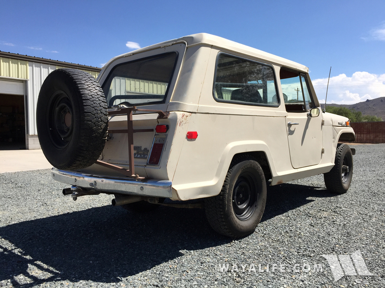

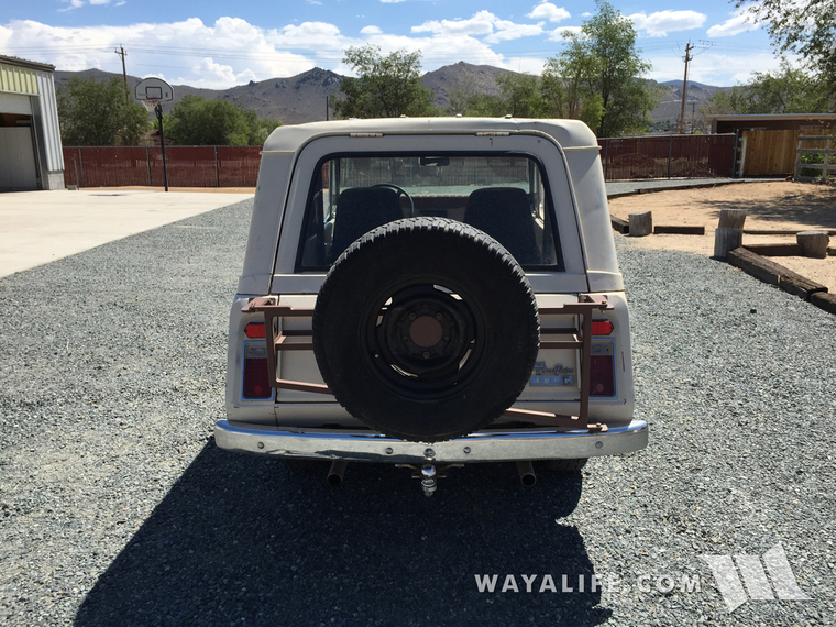

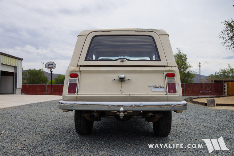

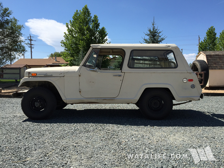

The rear tire carrier was a homemade deal and we'll be pulling it off.

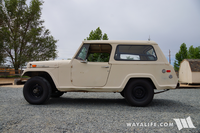

The passenger side is in much better condition but the hard top is pretty beat.

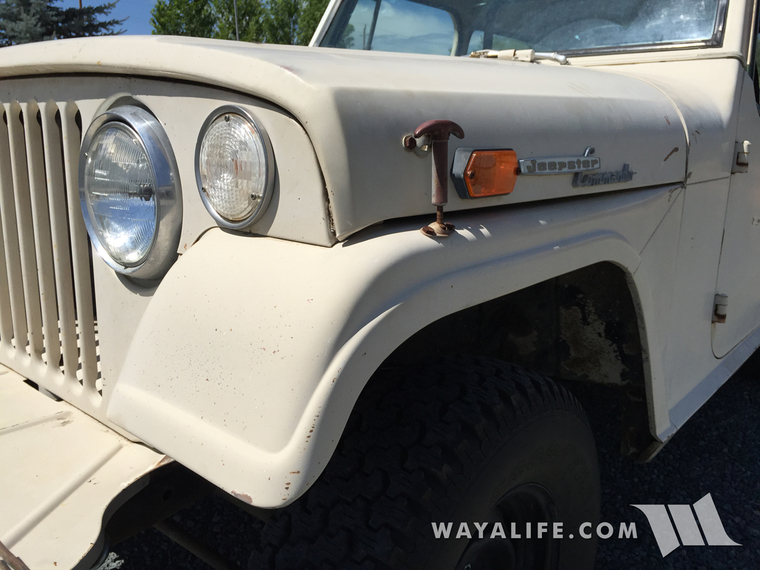

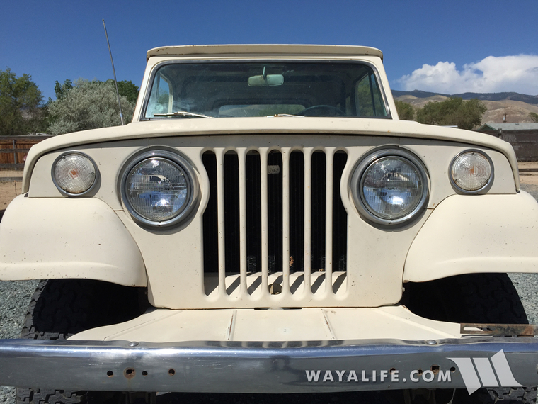

The front passenger side fender took on quite a ding when the old mirror that used to be on the door smashed into sometime long ago. Fortunately, fixing this shouldn't be too hard and if needed, replacement fenders can be found. The part that sucks is that there's a small growth of cancer on the rocker panel toward the rear tire. This will need to get cut out.

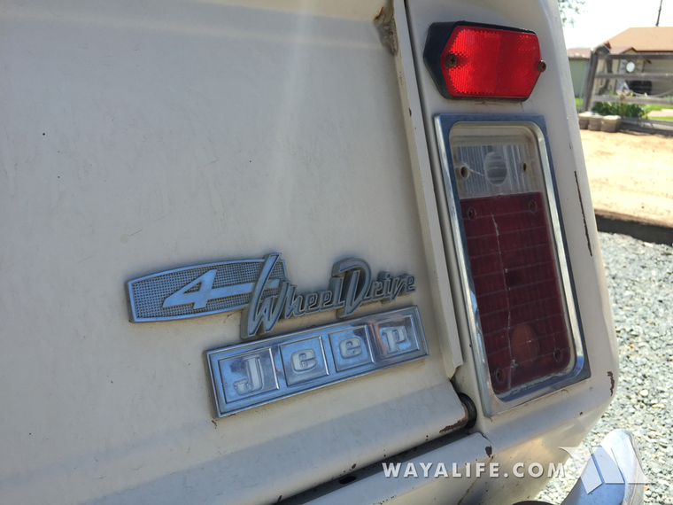

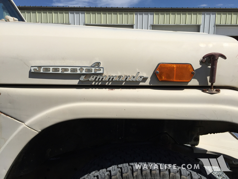

Here are a few detail shots of the Jeepster.

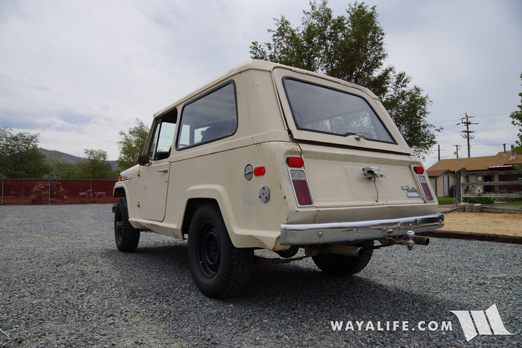

This will give you a better look at the fast back design.

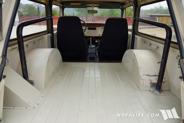

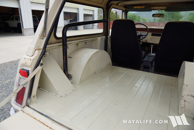

A look inside the back.

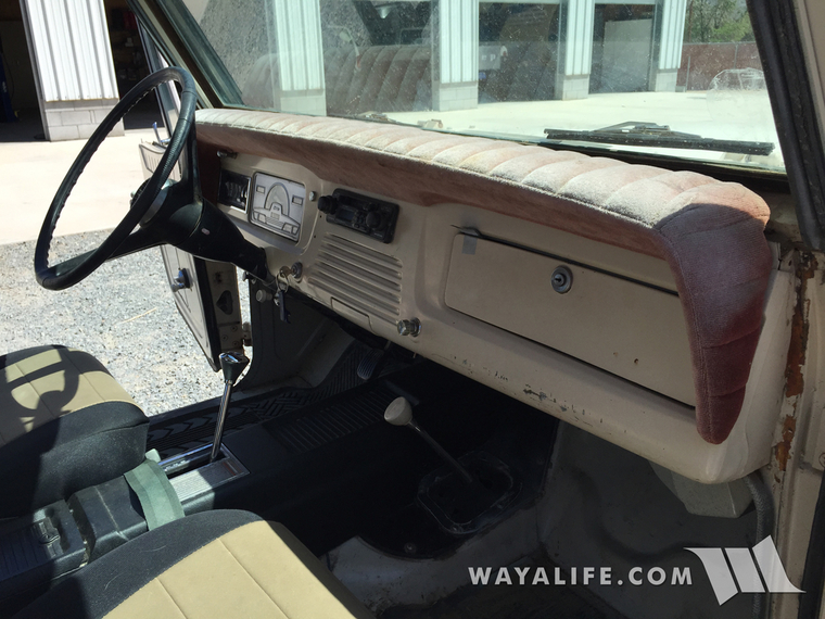

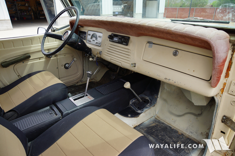

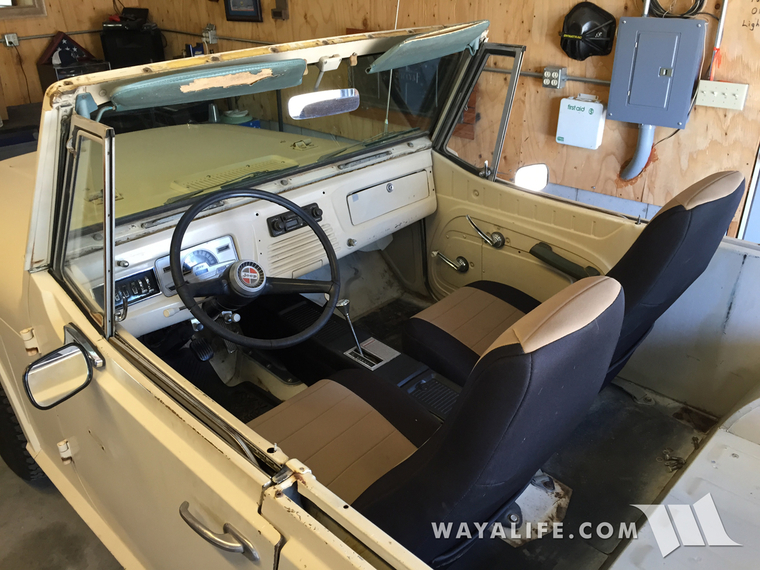

I know it's hard to look past the nasty upholstery (this is going in a hurry) but, here's a shot looking inside from the driver side door.
Shot from the passenger side door.

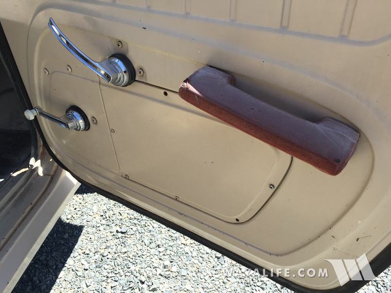

Surprisingly, the doors are very complete and both works great.

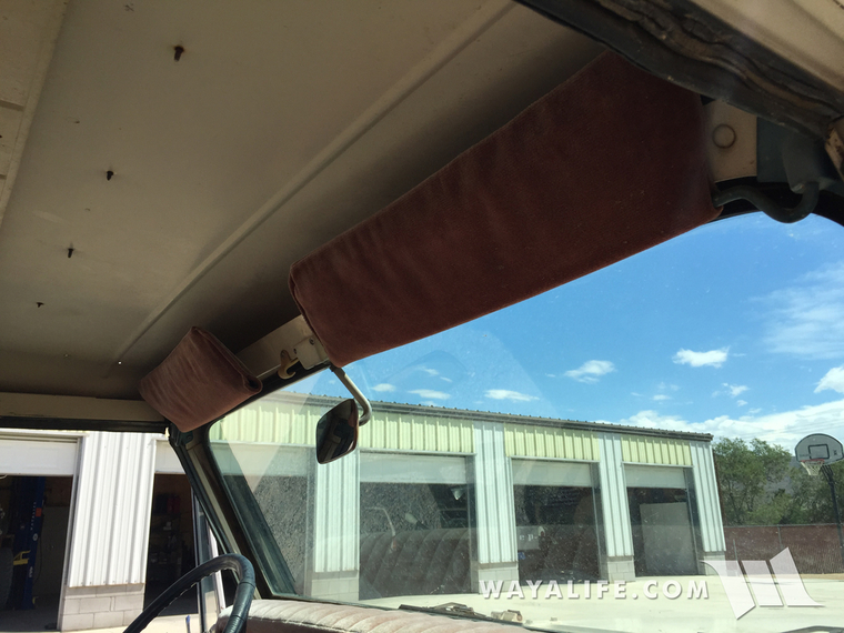

Nasty sun visors will have to be replaced.

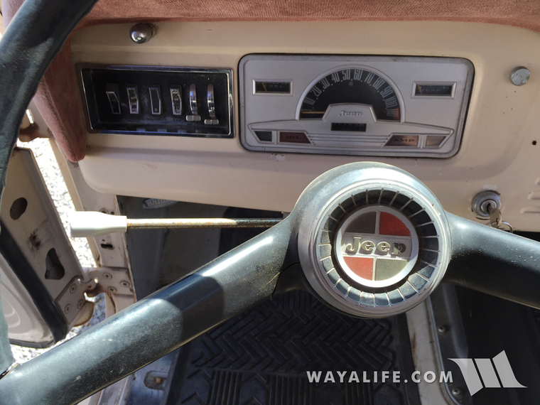

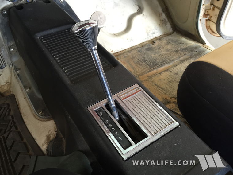

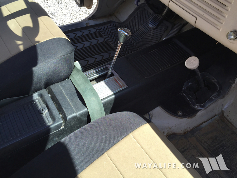

Shot of the center console and automatic shifter.

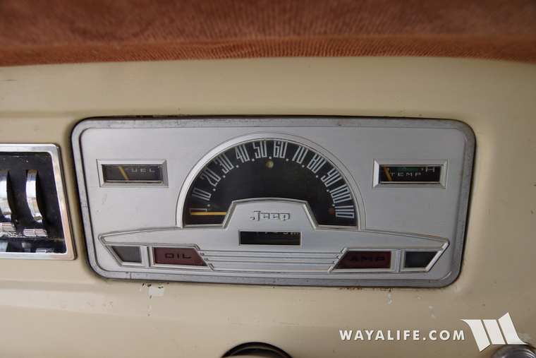

Amazingly, the dash switches and gauges all work.

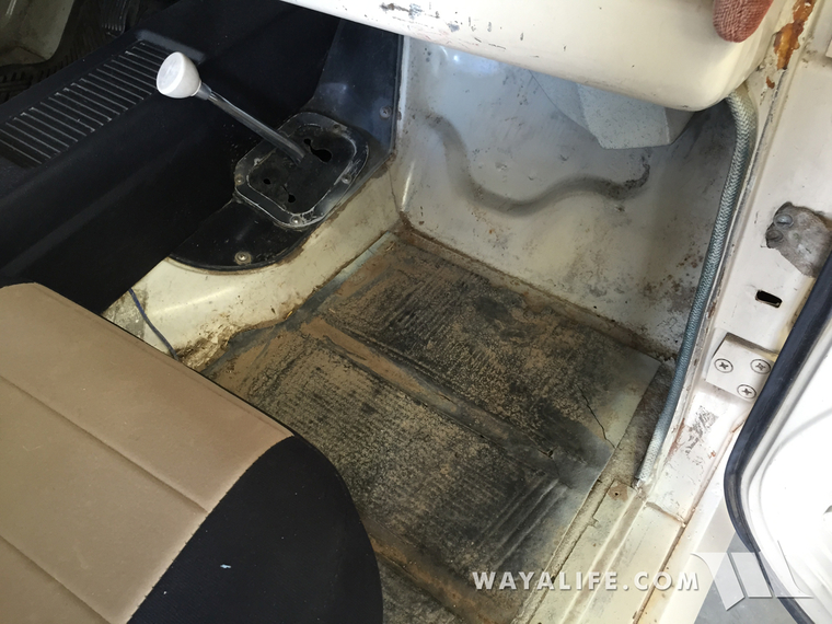

The floor pans have a rubber matting on them but, giving things a look from underneath, I saw very little if any signs of rusting through.

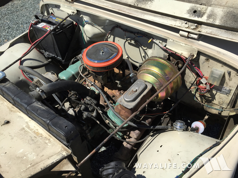

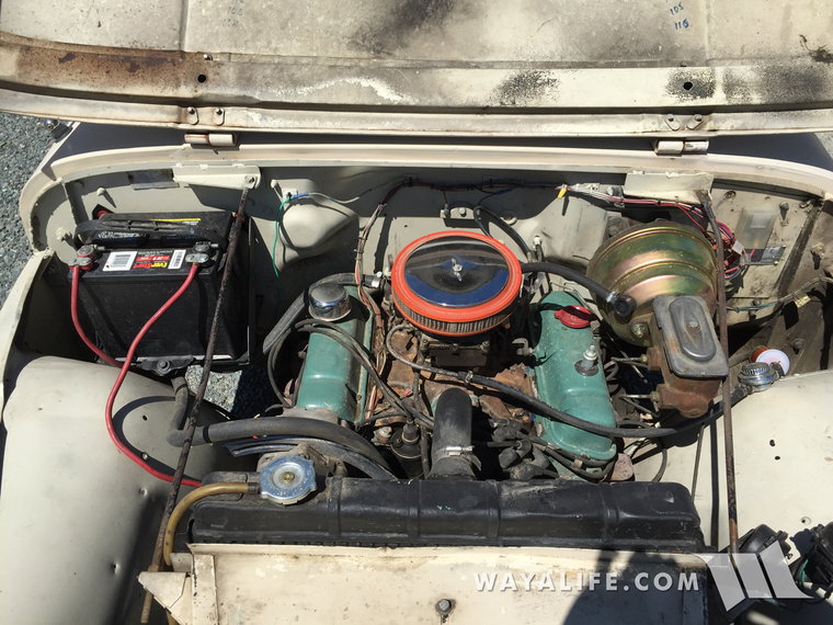

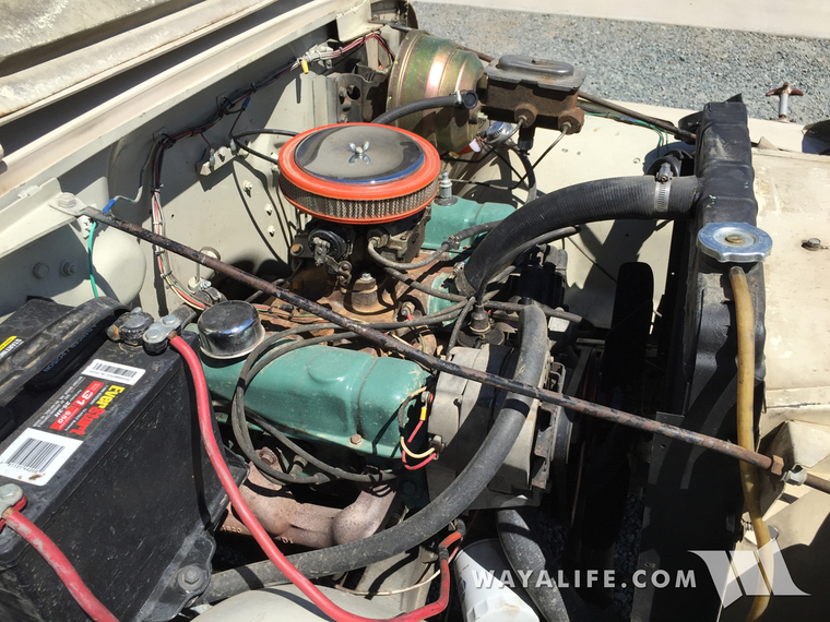

Finally, here are a few shots under the hood.

Okay, spent some time today washing, cleaning and removing crap off of our new Jeepster Commando. Here are a few shots of what it looked like with the homemade tire carrier off. Kinda reminds me of an AMC Gremlin :crazyeyes:
Cleaned up the inside a bit and started to remove the nasty upholstery. The vinyl underneath is pretty damaged but, for now, I prefer it this way.
Shot from the back - super clean now. You can kind of see the sun visors are free of the upholstery as well. Need to find some replacements.

It was hell to get off but, we finally got the old dash pad or crash pad off. While the upholstery peeled off easy enough, there was a ton of old adhesive still on the vinyl and baked on. Removing it has been quite a challenge and we're still working on it. The good news is that for the most part, the vinyl is free of cracks, or at least, any major ones. Here's a shot of the dash pad pulled off.
Here's a couple of shots of what we're trying to get off. Lacquer thinner is working well but, some of it is really stubborn.
Not too sure if we're going to be able to get this glob off.

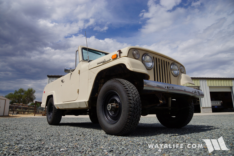

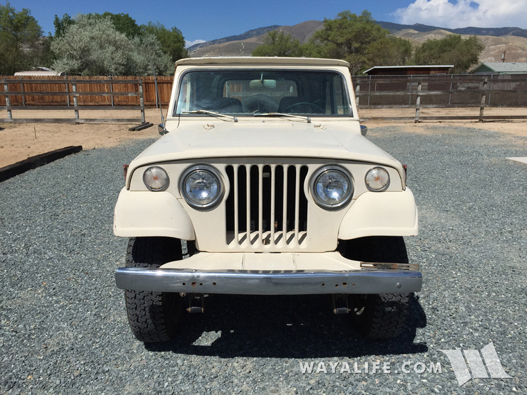

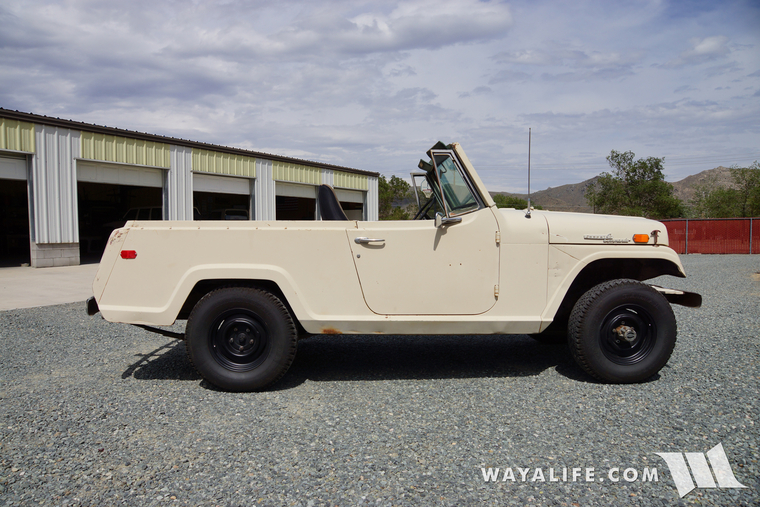

From day one, we had wanted to pull the hard top and roll bar off of this Jeepster and figured now was as good of a time as any to make it happen. Shot of the cab area with the top off.
Here are a few shots of what she looks like outside.
Just how she was meant to look!

Gotta a chance to work on Emma today. Started off with installing a new set of arm rests on the doors. Here's a before shot.
And here's an after shot.
Also cleaned up and installed a set of new sun visors. Here's a before shot of what the old ones looked like.
After painting the hardware and installing new sun visors.

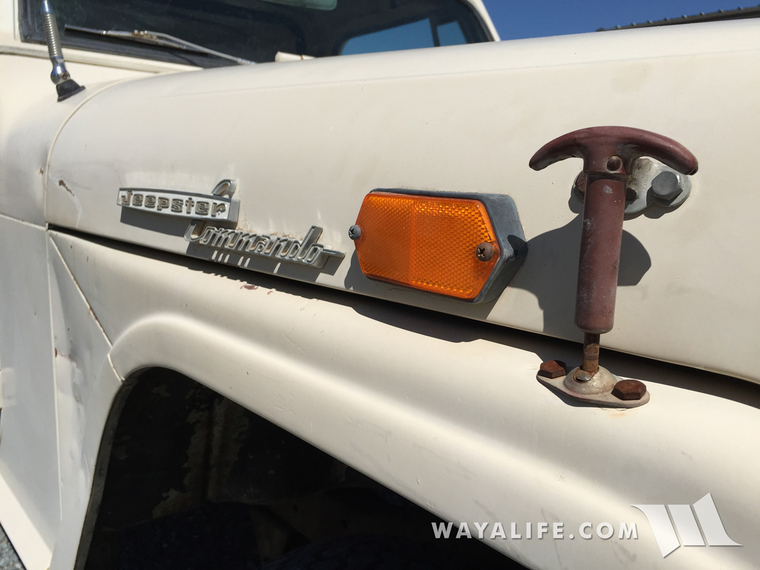

Installed a set of new hood latches. Here's what the old ones looked like.
And here's what the new hood latches look like.

Okay, it's been a while since I've updated this thread and thought I should bring ya'll up to speed on what we've been doing with Emma. As some of you may recall, the floor of this Jeepster Commando C101 was cover with a dynamat like material and we were concerned that it might be hiding some rust or worse. Needless to say, we decided to pull up the matting to see what was going on underneath it.
Unfortunately, our suspicions were right as we found several rust spots that needed to be dealt with, multiple holes that needed to be plugged and even a large hole with cracks radiating from it that needed to be fixed.
This is the large hole with the cracks around it. Looks like it once was the location of an improperly made seat mount.
Here's a shot of what the floor looked like after removing all the matting.
Time to clean up the loose rust and prepare the holes and cracks areas to be welded up.
With most of the loose rust removed, there were a few spots that broke all the way through and would need to be patched or cut out.
As you can see here, I was able to clear enough rust to open up a pretty good depression but, enough metal was still present that I decided to just patch it. The gaping hole to the right would need to be repaired.

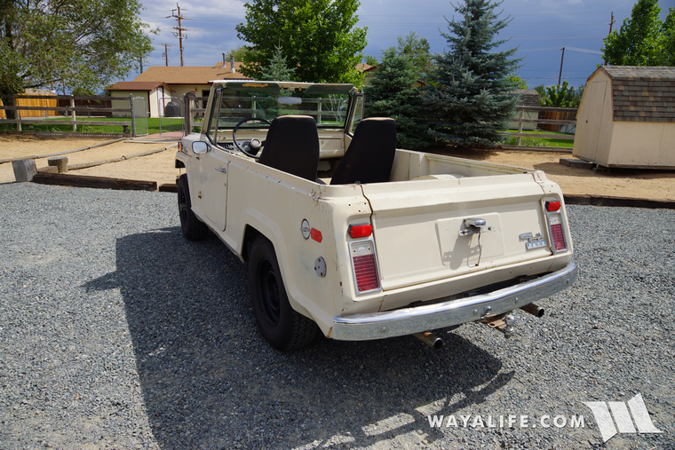

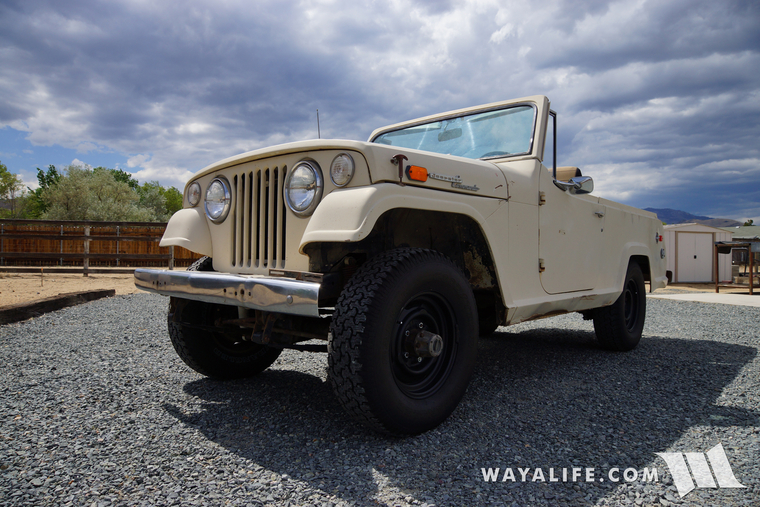

Finally, here are some all around shots that we took soon after Emma's first drive since bringing her home.
Shot of Emma's rear end with new pre-1980 Nevada plate.
A few interior shots.
Looking down and into the tub.
Up front shots and up higher.
3/4 mug shot.
Head on mug shot.
Looking into the smokey sun.
New hub caps.
