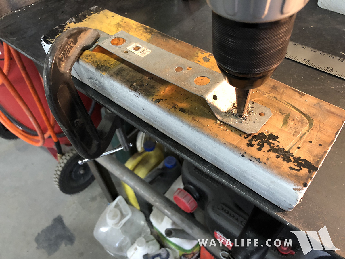

8. Use a center punch to mark the point you made in step #7.
9. Use a unibit to drill a 1/4" hole through the point you just center punched as well as the small existing hole on the opposite side.
This is a shot of what your new rear cross member license place relocation mount should look like when done.
