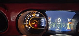

when I am driving in my jeep, I notice in the shifter lights up if I am in 2 h or 2l I am in and notice the light going out there anything I can do to fix that? I have a 2018 jeep Wrangler
right above the steering wheel you have your rpm gauge and right to that it tells you what gear you are in, I am in 2h, and has I am driving I can see my 2h light dimming out from time to time, is there a bulb or fuse to fix that?

Are you able to provide a photo of the part of the dash where this is happening?
