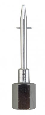

That looks like a great option. What attachment do you use to grease them?
You use a needle attachment with a blunt tip.
Looks like this. They make ones that clip into a regular grease attachment as well.
Works 100x better than the standard nipples/attachments.

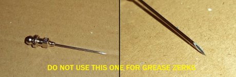

I've only had these for a short time but haven't hit them yet. The attachment is called a Lincoln needle. It's not the tiny one that looks like a sewing needle though.
