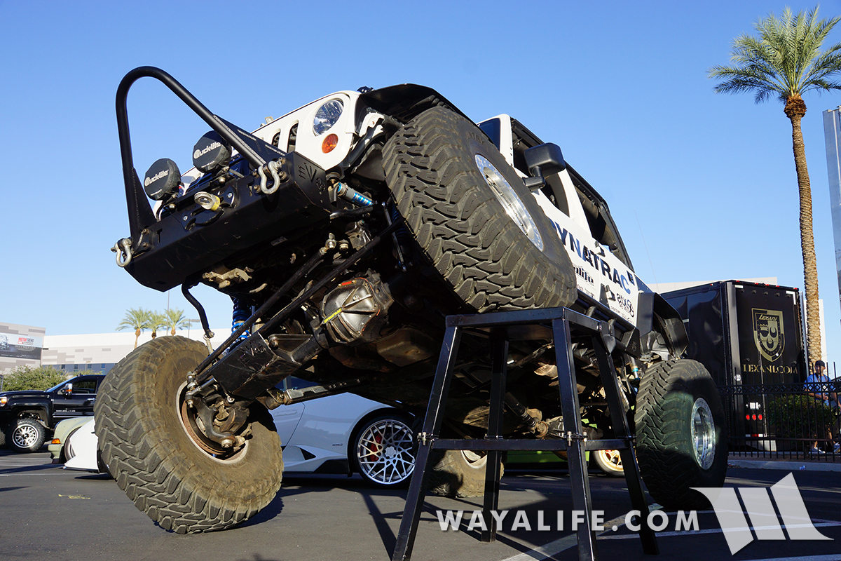

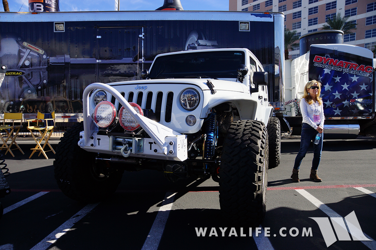

At SEMA a couple of years back, I was helping Dynatrac display 2 JK's running the the exact same EVO DTD suspension system only one was running an Antirock in the rear. Moby got up their tall ramp without any problems as you can see here.
The other JK, I was able to get it up on the ramp but the rear sway bar was giving so much resistance that it was on the verge of flopping. Out of safety concerns, Dynatrac decided to leave it sitting on all 4.
Seen the same thing on the JKX PNW. Rigs with the Antirock ended up breaking a rear window or close to it but Moby with his factory rear sway bar did not.
