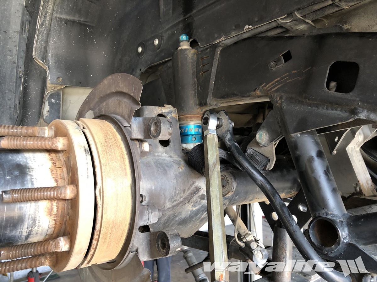

The other bit of maintenance we've been needing for a while now are new heims on all our links.
