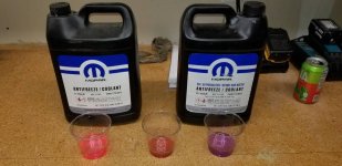

So I'm finally home from my work trips and getting ready to drop the new radiator in my 2015. I'm familiar with the difference between the OAT and HOAT but the color that came out of my 2015 really has me scratching my head. Because I have a 12 and a 15 I have bottles of both on hand.
Left is the 5 year right is the 10 year and in the middle is the sample I pulled out of my 2015 AEV 5.7 swap. Sure as hell looks to me like it has 5 year in it.
I have played with the light from all angles and unless it looses the purple color over time being used I see no purple. Maybe a little pink tint but the 5 year has that same pink tint.
Any guesses on if the sample I pulled out of the 15 is actually the orange 5 year stuff or actually the purple 10 year stuff?
Ed if you are reading this maybe you can weigh in on what was in it? 20210307_192108.jpg20210307_192114.jpg
