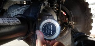

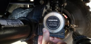

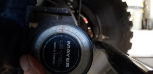

I realize this is an old thread, but I have no clue as to what my front caster or pinion should read? I have 3.5 lift, To me it drives great. Nothing to compare it to. Have a vibration at 60 mph and only 60 mph not 59 or 61. Even with the new J.E. Reel front shaft. Attached a picture of the angle. Any help would be appreciated.20181009_144111.jpg20181009_144119.jpg20181009_144102.jpg
Usually if a vibration only occurs at a certain speed, it's related to tire balance.
That's what I was thinking. If I remember correctly I did drive It without the front shaft and it was still there. My real question is what do you think of the angle? Thanks
If your ground is a perfect flat 0, then where you are measuring at on your pumpkin (from the passenger side view), you should be at 88 according to this thread: https://wayalife.com/showthread.php...nt-End-Alignment?p=42391&viewfull=1#post42391.
So it looks like you could add about a degree or slightly more to obtain optimum caster. However, as caster increases, front drive line angle is less ideal. So, if it is a driveline vibration that you have, it will probably get worse if you increase the caster. If you're happy with the way the Jeep's steering feels, I wouldn't mess with the caster personally.
Thank you. Appreciate the help.
