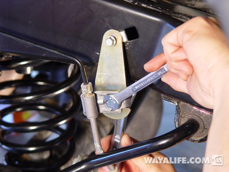

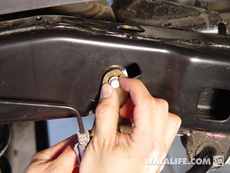

Most extension brackets look something like this and should mount up with ease...
1. Using a 10mm socket and the factory hardware, install the rear brake line extension brackets onto the frame rails with the bends pointing toward the center of your Jeep and the notches pointing backward.
2. Secure your rear brake lines to the new extension brackets using the bolts, washers and lock nuts provided with the kit. You will need a 7/16″ socket and wrench for this job.
Yes. I have those same brackets. But for some reason my brake lines won't reach bottom of the new brackets. ??
