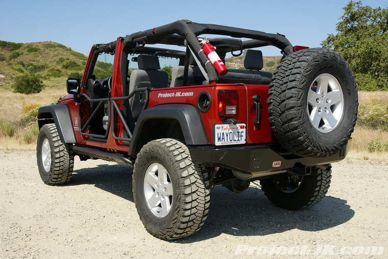

I have a 35" tire on pro comp wheel w/4.75 backspacing, I bought a 1inch wheel spacer to make it fit with daystar isolators, 3rd brake light sits perfectly above tire.
Thanks for the response and picture. Looks like it shouldn't be an issue. In that picture do u have the 3 inch Evo springs installed?
Teraflex Budget kit currently; I'm waiting for the opportunity to install the Evo coils and related parts I recently purchased.
Again, you will be just fine carrying a 35" spare on your tailgate SO LONG AS you make sure to keep it from jiggling around. Extended isolators will help you to mitigate that. Over the last 7+ years, I have known plenty of guys to run this setup and a few still are. I myself have run this setup more than once using my factory wheels. Here's a shot of a 35" MT/R on a factory tire carrier. I had a spare wheel spacer that I used to help make it possible but an adapter will do the job as well. Please note that the 3rd brake light is a bit harder to see but, still installed.
