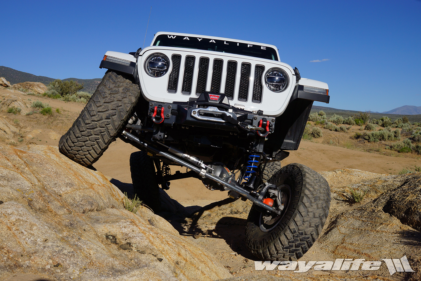

Ramping one side or the other on a Jeep is NOT a good way to measure the amount of compression that you will ultimately get out on the trail. In a simple test like that, your track bar will always allow for more compression or droop on the side that it's not attached to. If you take your Jeep on the rocks and cross up your suspension (opposing flex), you will see things very differently. This is why companies like Metalcloak use their trailer with those electric tables to market their products.
Example of opposing flex.

The most a fork lift can do is give you a general idea of how much flex you have. Most of what you see with that is droop. The more you compress a coil, the more it will resist the compression and unless you have an opposing force, leverage from the rear end, you will never see the full amount.
Also, assuming you're still running factory control arms, the clevite bushings WILL offer resistance as they are bonded rubber. This is yet another reason why you need opposing flex to see full compression.
