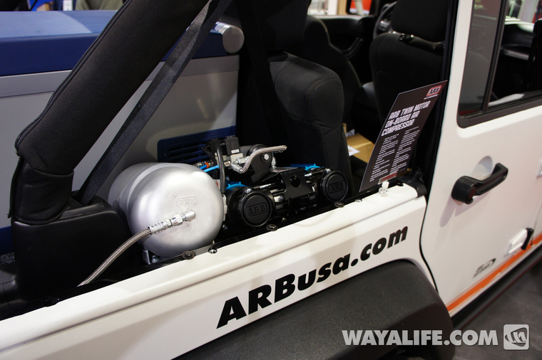

With some creative work, you might be able to get one installed under your hood but, ARB installed theirs here...
Not such a bad place if you ask me. I like their regular HD pump and it works well - I can only imagine the dual setup would be better.
