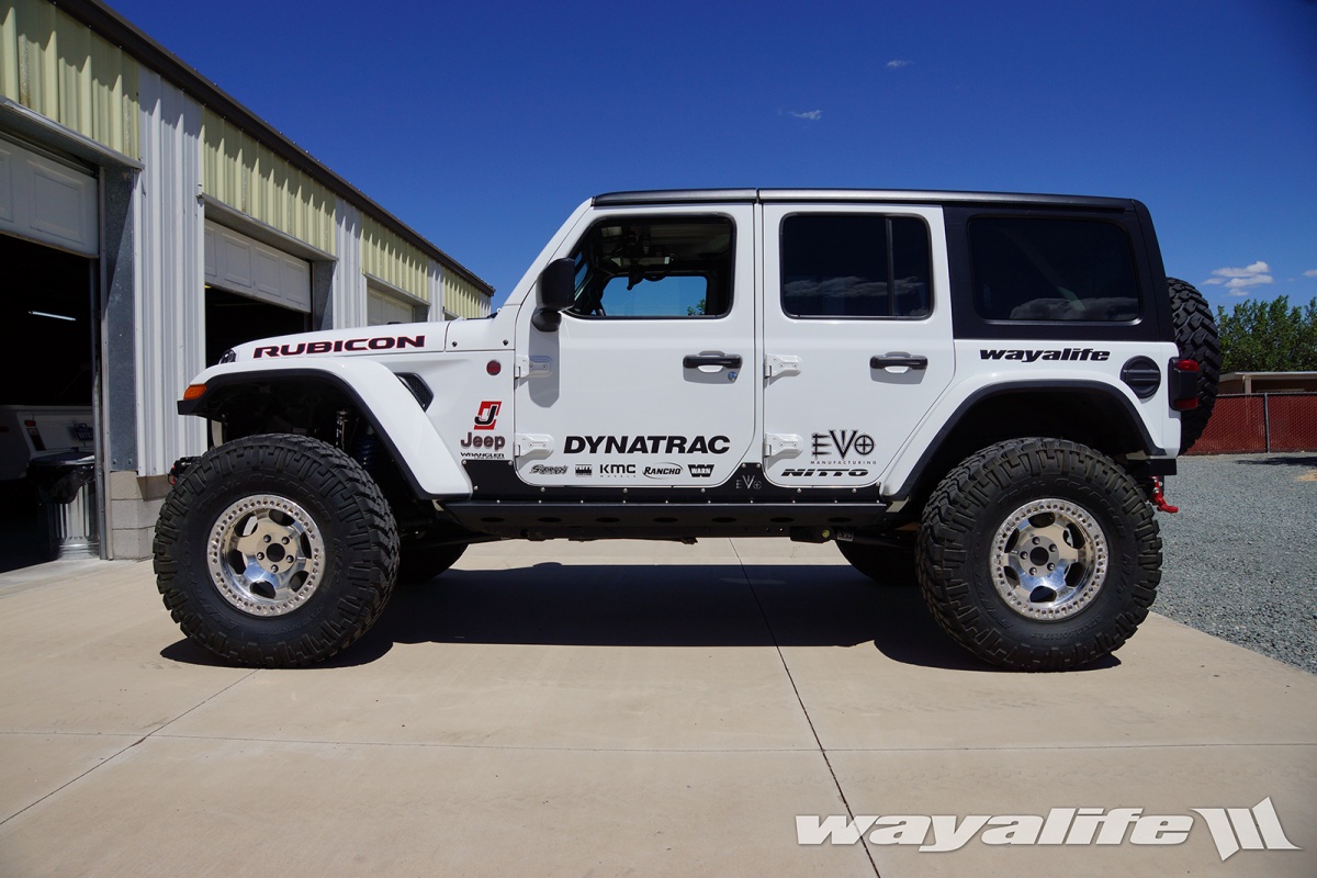

Here's a shot of how much our 12.50 Nitto Trail Grapplers mounted on KMC XD231 wheels with 4.75" of back spacing stuck out past the fender flares.
And, here's a shot of how much they stick out with 1.75" wheel spacers installed.

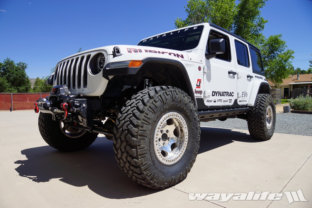

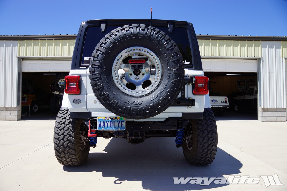

Here are some overall after shots to give you an idea of what JET looks like now.
Here's another close shot from up front to show how much our tires stick out past the fender flares.

All is good in the world! We still have some fender rubbing but really couldn't care less. Certainly, it's nothing to whine about. Our sidewalls aren't making contact with the sway bar link ends and that's all we wanted to fix. :yup:

Looks good. I really like the feel of a wide stance. Did you change anything with the rear sway bar to get that much flex in the rear?
If I run spacers again it will definitely be Spidertrax, just like last time. I had a lot of miles on mine with absolutely zero issues before I changed out wheels and tires. Or was that “we”? [emoji6]
LOL - "we" of course and yes, Spidertrax is the only way to go. I can speak from first hand experience that running a cheap knock off will only lead to trouble or disaster. I've made that mistake in the past but only because I was in a pinch and ended up almost losing a wheel on the highway. :shock:
Nope. If you want BIG flex, OE is the only way to go. Drop brackets were installed but only so that the sway bar would clear the coilovers at a full droop.

If you went less than 1.75, would you have issues with the stock studs?
Yup. If you look at the second pic I posted carefully, you will see that the factory studs sit flush with the spacer. Anything less and you would have a problem.
