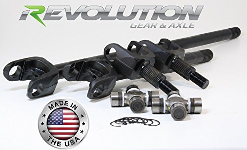

5.13's would be the right ratio for 37's but 4.88 isn't that far off and I think you'll be okay with them. Chromoly shafts with full circle clips is something you'll probably want sooner or later but I don't think you'd need to rush into them if you're on a budget. Your driver side shaft will be the first to go but I had gotten 80,000 miles out of my factory passenger side shaft before replacing it and still keep it as a spare. If you keep playing hard, you will bend rear shaft flanges and I would recommend Revolution for that if only because they're made in the USA and offer such a great warranty.

I'll keep the 5.13 in mind for the future. I'll also look into Revolution. I also like the idea of having a spare set of axles. The budget isn't too big a deal but I don't want to waste money needlessly. Since I'm really just getting into all this seriously and wanting to do as much of the work myself as I can ( so I know how to fix it when I break it), are the shaft flanges something I can do myself or not?

I wouldn't worry too much about 5.13 unless you're going to upgrade axles. If keep playing hard, this is something that will be on your to do list. For me personally, I would throw as little money as possible at your factory axle and save up for something like a ProRock 44 up front. Bend flanges on rear shafts cannot be fixed.
FYI the axle shafts on the Rubicon are different lengths, Right vs. Left. On the non-Rubicon versions both sides are the same. It's nice to only have one size to carry as a spare.
