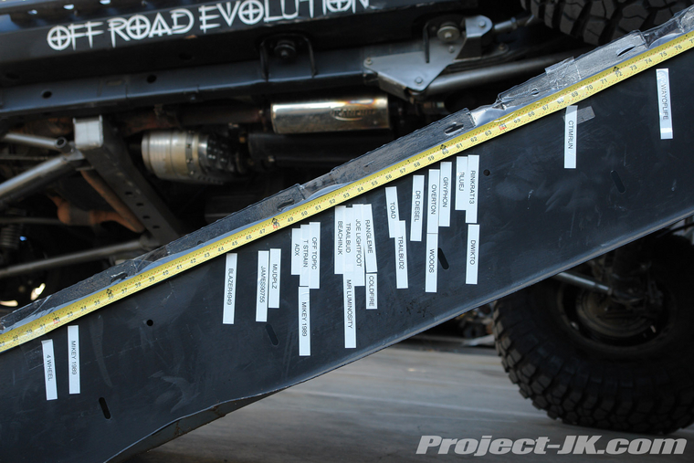

I hate to burst your bubble but, if you've ever run your Jeep on an RTI ramp along side other similarly built rigs, you would find that ALL score about the same. This is regardless if you are running a 4-link setup, a 3-link setup, long arms or short. In the end, you are still limited by the length of your shocks and the amount of travel they provide. The only time you will see a noticeable difference is if you were to run coil overs.
Here's a shot of how far up a group of JK's got on a 30° RTI ramp. Please note, what you are seeing is everything from a stock 2-door, stock 4-door, budget boost lifted, long arm lifted and everything in between and made by a myriad of brands. As you will see, most all got up to about the same range with two exceptions - CTIMRUN and WAYOFLIFE. Both were running short arms and Tim had coil overs installed up front only. I was running coil overs front and rear.
Needless to say, before you kick down any money on a kit with the hopes of gaining more flex, just realize that you may not be getting as much as you're hoping for.
