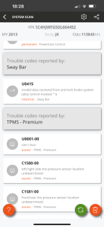

Ill have him run codes on it and see what pops up.
