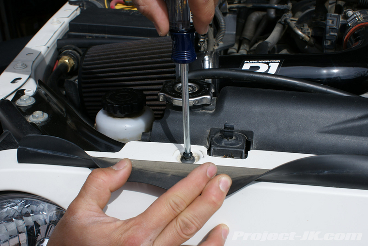

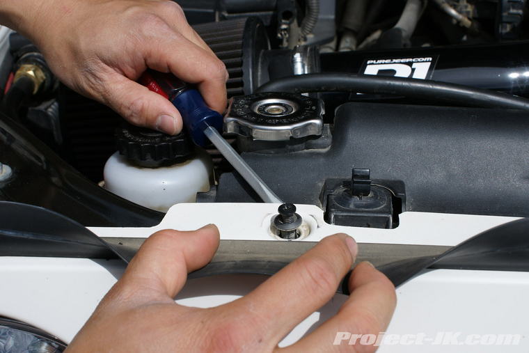

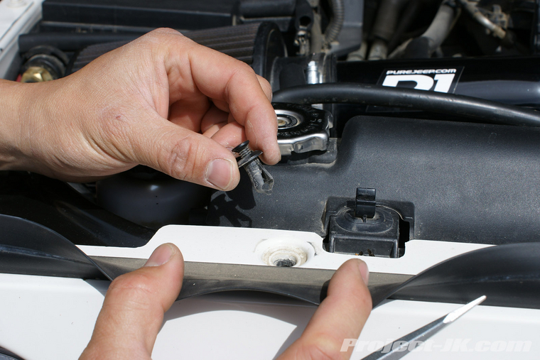

1. Park on level ground, open your hood and then using a phillips screwdriver, loosen the plastic retaining screws securing the top of the front clip in place.
2. Unfortunately, you may find that a majority of these plastic screws simply turn in place. If this is the case, use a flathead screwdriver to help pry them up and out of their holes as shown in this pic.
3. Once loose, the entire plastic screw and expansion sleeve should pull up and out of their mounting holes.

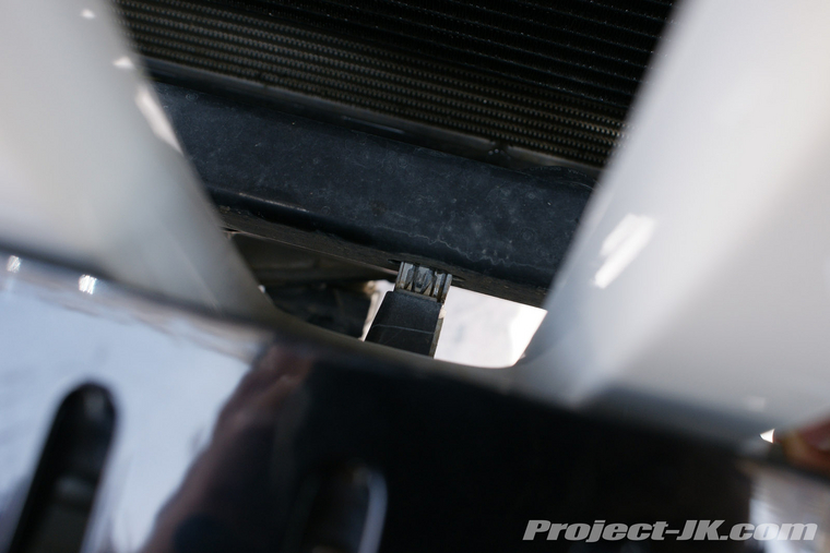

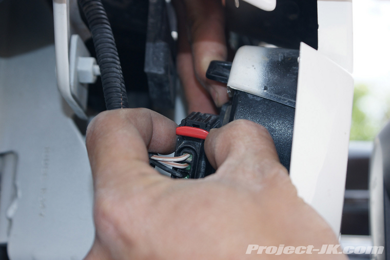

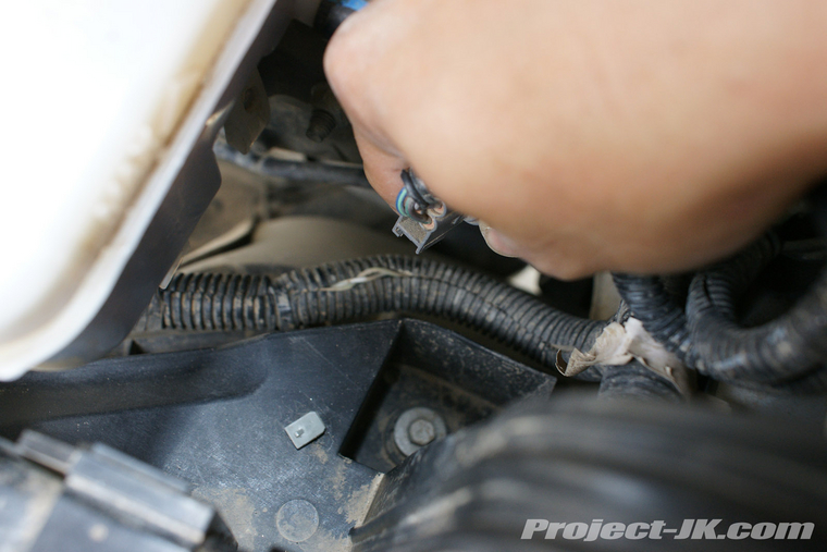

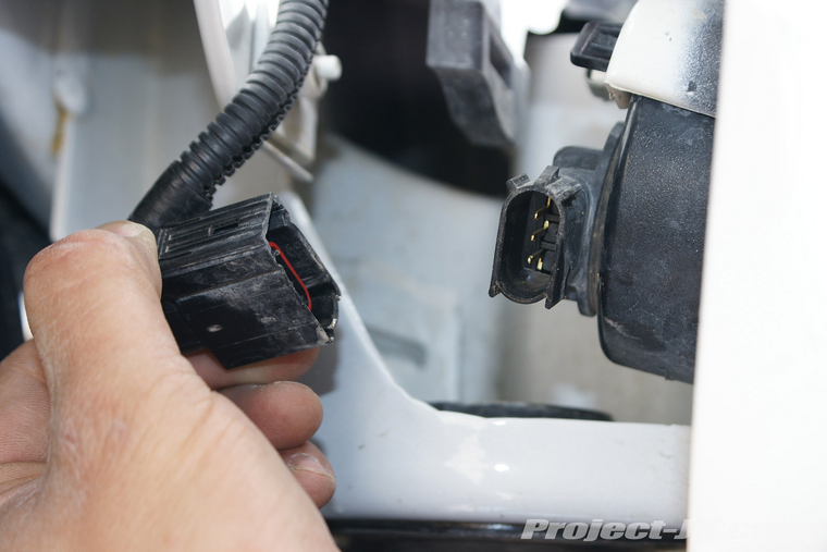

5. Lean the front clip forward a bit to gain access to the indicator lights. Then, take the wiring harness plug and pull the red locking tab back.
6. Squeeze the wiring harness plug and pull it out of the indicator light socket.

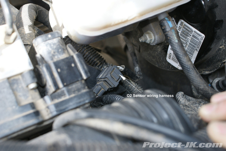

8. Go to the driver side of and find your O2 sensor wiring harness which is located below the brake master cylinder as shown in this pic.
9. Slide the wiring harness plug off the mounting tab as shown in this pic. This is done to provide enough slack for the wiring harness after the body of your Jeep is lifted 1″.

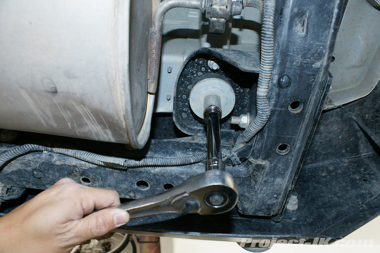

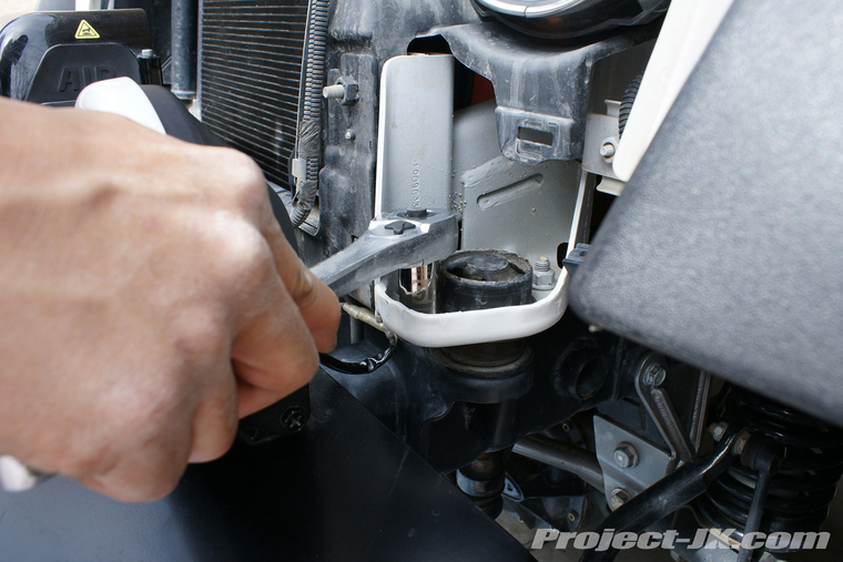

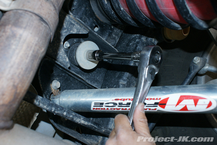

10. Using an 18mm socket, loosen but do not remove the forward most body mount nut on the driver side of your Jeep.
11. Using an 18mm socket, loosen but do not remove the 3 body mount bolts along the driver side frame rail as shown.
12. Moving towards the rear of your Jeep, use an 18mm socket to loosen but do not remove the body mount bolt located on the 2nd to the last cross member between the driver side rear shock and coil as shown in this pic.
13. Use an 18mm socket to loosen but do not remove the last body mount bolt on the driver side which is located on the rear corner of next to the muffler as shown in this pic.
14. Repeat steps #10 through #13 on the passenger side.

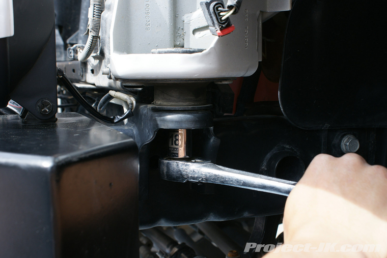

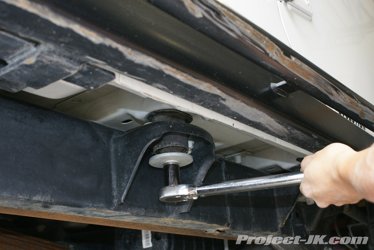

15. Back on the driver side again, use a 16mm socket to remove the 2 nuts securing the forward most body mount to the body.
16. Remove the nut and washer securing the forward most body mount to the frame.
17. One by one, loosen the other 5 body mount bolts along the driver side frame rail to the point were they are just dangling in place. Then, using a pry bar, separate the bolt and washer from the body mount as shown in this pic.

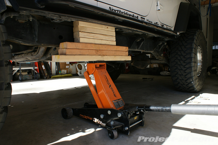

19. Stack cut lengths of 2×4 on top of a floor jack, position them under the body and just behind the pinch seam.
20. Slowly lift the body of your Jeep up off the driver side frame rail and go just high enough where you can remove the forward most body mount and be able to slip in a 1″ puck between the body and all the other body mounts.

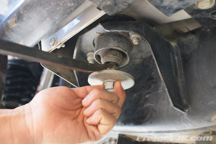

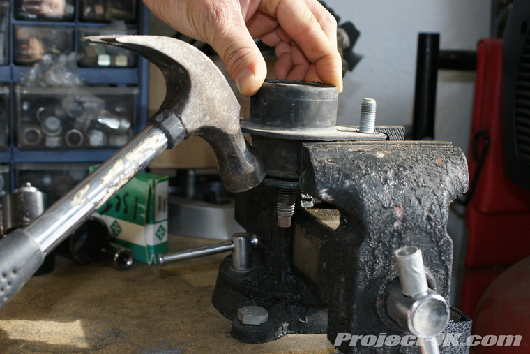

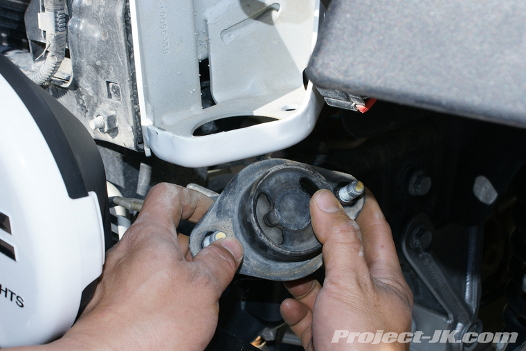

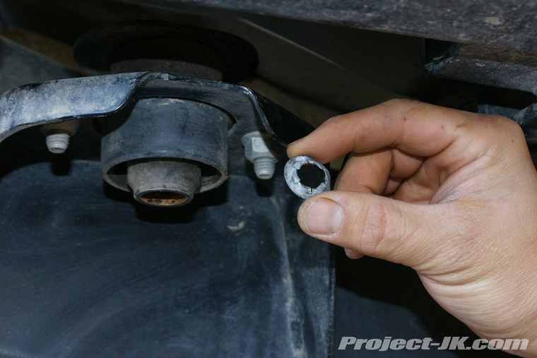

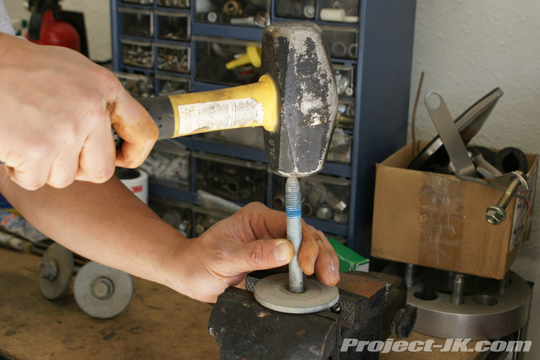

23. Take the body mount that you just removed, place it in a bench vice and knock off the large washer attached to the end of it with a hammer as shown in this pic.

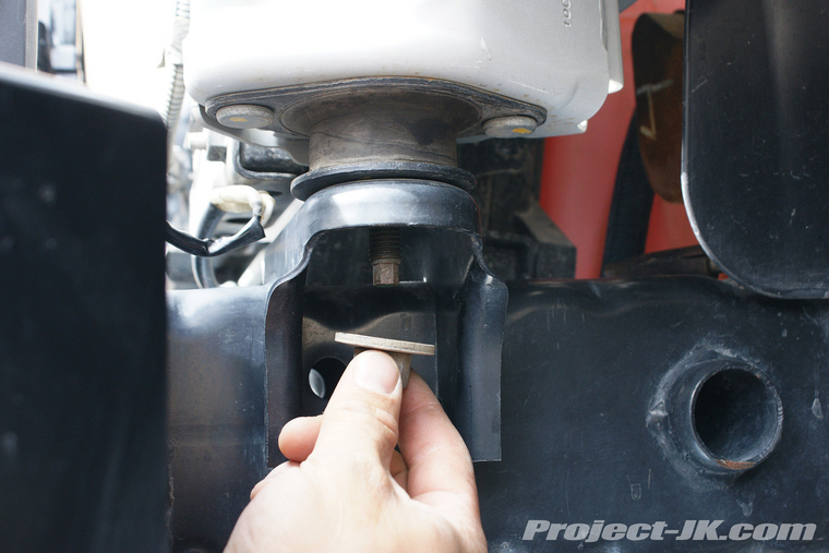

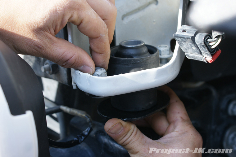

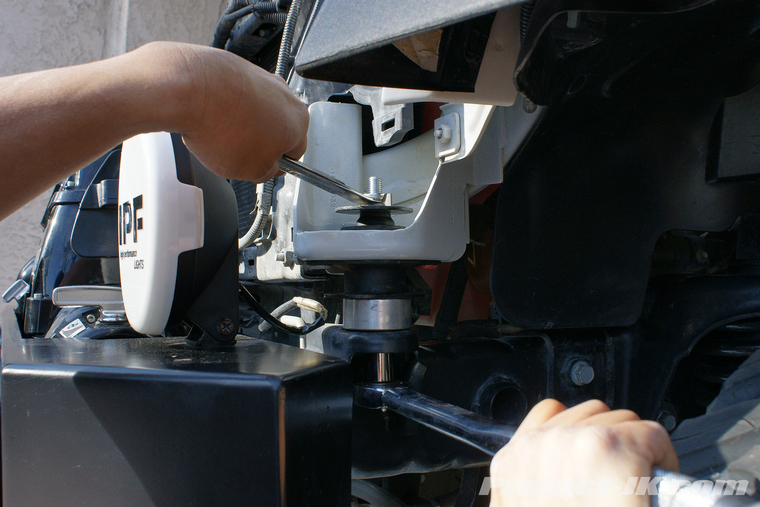

24. Install one of the new OEM body mounts provided with the M.O.R.E. 1″ body lift up into the forward most position.
25. Using a 16mm socket, secure the new body mount in place using the factory nuts. Tighten these nuts to 40 ft. lbs. of toque.

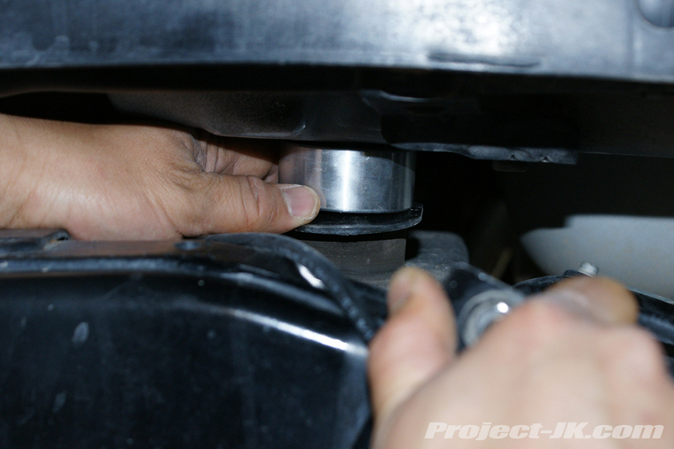

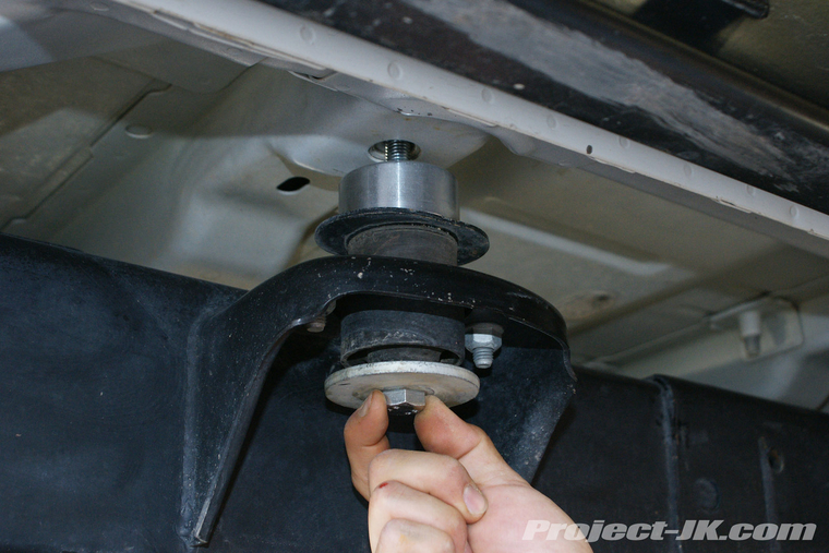

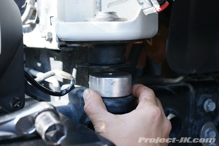

26. Insert one of the 1″ pucks in between the OEM body mount and frame as shown in this pic.

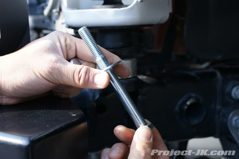

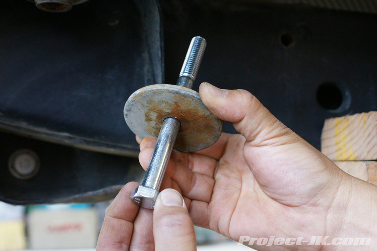

27. Take one of the new 12-1.75×130mm bolts provided with the kit and then slide one of the 1/2″ flat washers onto it as shown.
28. Insert the bolt and washer you just assembled up through the frame, the M.O.R.E. aluminum puck, and OEM body mount. Then, take the factory washer you removed back in step #23, place it on top of the body mount and secure everything in place using the supplied locknut. Leave the bolt and nut finger tight for now.

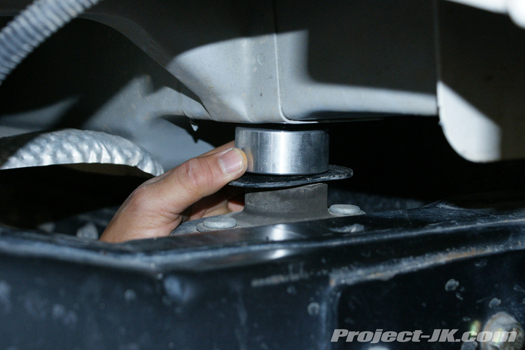

29. Insert a 1″ puck on top of each of the 3 OEM body mounts situated along the driver side frame rail.
30. Insert a 1″ puck on top of the body mount located on the 2nd to the last cross member between the driver side rear shock and coil as shown in this pic.
31. Finally, Insert a 1″ puck on top of the body mount located on the driver side rear most corner.

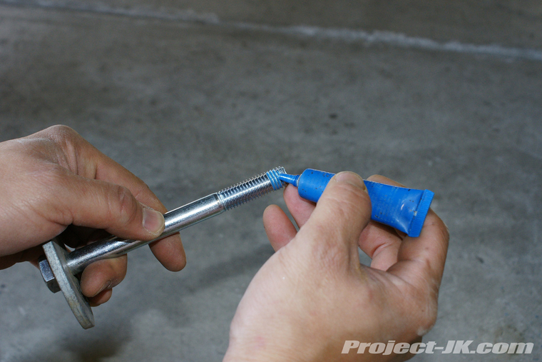

33. One by one, apply some Loc-Tite on to the threads of your new 1″ body lift bolts provided with the kit.

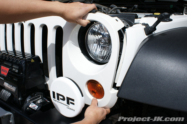

36. Hold your front clip up to the front of your Jeep and then reconnect the wiring harness for your indicator lights and lock them into place by sliding the red tab in.
37. Secure the bottom of your front clip to the front of your Jeep by pushing the trim tabs in place.
38. Using a phillips screwdriver, secure the top of the front clip your Jeep by inserting and screwing in the plastic retaining screws.
